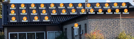

rogerthn
Posts: 28
Joined: Thursday 26 July 2018 12:07
Re: SolarEdge individual optimizer dzVents script
Post by rogerthn »
Thanks :D
Screenshot 2023-05-05 110549.png (144.89 KiB) Viewed 26028 times
