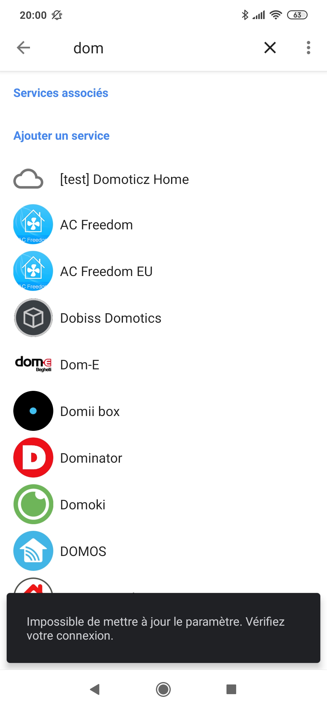

k20human
- Posts: 6
- Joined: Friday 02 October 2020 16:59
Re: Domoticz-Google-Assistant (dzga)
I try to use dzga but wihtout success for now ...
I follow every steps on the wiki : https://www.domoticz.com/wiki/Google_Assistant
My dzga is successfully installed and accessible via HTTPS (Let's Encrypt already use for others websites on the Rasp, like Domoticz)
When i try to add my application on my Google Home app i have an error
When i watch the logs on dzga i see this :
In my nginx logs i see this :
I try this url POST /smarthome on Postman and it give me this response :
What can be wrong with my configuration ?

Can you add dzga ([test]testapp)in google home app?k20human wrote: Friday 02 October 2020 17:06 Hi,
When i watch the logs on dzga i see this :In my nginx logs i see this :Code: Select all
2020-10-02 16:50:15 - DEBUG - Host: assistant.emee.info X-Real-IP: 66.249.93.107 X-Forwarded-For: 66.249.93.107 Connection: close Content-Length: 80 Content-Type: application/json;charset=UTF-8 Google-Assistant-API-Version: v1 Authorization: Bearer XXXXXXX User-Agent: Mozilla/5.0 (compatible; Google-Cloud-Functions/2.1; +http://www.google.com/bot.html) Accept-Encoding: gzip,deflate,brI try this url POST /smarthome on Postman and it give me this response :Code: Select all
66.249.93.107 - - [02/Oct/2020:16:54:24 +0200] "POST /smarthome HTTP/1.1" 404 67 "-" "Mozilla/5.0 (compatible; Google-Cloud-Functions/2.1; +http://www.google.com/bot.html)"What can be wrong with my configuration ?Code: Select all
Page not found!: not authorized access!!

No i can't add dzga. I have the 404 error in my logs when i try to add it.DewGew wrote: Friday 02 October 2020 19:45Can you add dzga ([test]testapp)in google home app?k20human wrote: Friday 02 October 2020 17:06 Hi,
See error in attachement when i click on my test app
- Screenshot_2020-10-02-20-00-49-324_com.google.android.googlequicksearchbox.jpg (257.08 KiB) Viewed 35766 times
