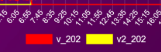

Hi, really love all the new stuff in the graphs! Thanks!!
Small problem now however. I am on 3.4.2.
I want to show the legend, with custom names.
If I put this in the config, it shows the default legend (as expected)
blocks['graph_202'] = {
    devices: [202],
	graphTypes : ['v', 'v2'],
	legend: true,
But when I use this, Dashticz won't start (Error in config.js)
    devices: [202],
	legend: {
		'v_202': 'Dal tarief',
		'v2_202': 'Normaal tarief'
I am doing something wrong or is this a bug?

@toro
Try this
    devices: [202],
	legend: true,
	legend: {

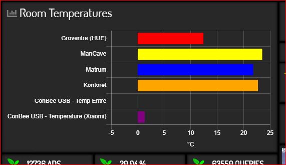

Question...
Realy like the GRAP funktion.. Smooth and nice...
Is there an option to rename the devices as they show up in the graph, I want them to show as there are named in Domoticz.
Graph block:
blocks['all_zones'] = {
   title: 'Room Temperatures',
   devices: [1831,2358,3016,1115,2887,2396],
   groupByDevice: 'horizontal',
   graphTypes: ['te']
blocks[1831] 	= {title: 'Groventre', width:3};
As you can seem the 1831device is named "Groventre" in Dashticz but shows up as "Groventre (HUE)" in the graph..

toro wrote: Saturday 04 April 2020 0:13 If I put this in the config, it shows the default legend (as expected)
    devices: [202],
	legend: true,
    devices: [202],
	legend: {
Your last graph block works fine for me, there are no errors with it. The graph displays correctly. Please can you post your config.js (redacted)?

Minglarn wrote: Saturday 04 April 2020 9:53 Is there an option to rename the devices as they show up in the graph, I want them to show as there are named in Domoticz.
   graphTypes: ['te']
I have raised this as a feature request here:
https://www.domoticz.com/forum/viewtopi ... 78&t=32026
Minglarn
Posts: 214
Domoticz version: v3.8153
Location: Stockholm / Sweden
Re: Dashticz Graphs - New Features, Fixes & Updates
Post by Minglarn »
clinkadink wrote: Saturday 04 April 2020 10:29
   graphTypes: ['te']
Nice!
Great work btw with the GRAPH... Makes everything so easy... :D
Again... Big Thanks!

toro
Posts: 47
Joined: Wednesday 09 August 2017 23:05
Post by toro »
clinkadink wrote: Saturday 04 April 2020 10:23
    devices: [202],
	legend: true,
    devices: [202],
	legend: {
Thank you so much for testing!
Because the graph works for you, I tried some more and figured it out.
In my code pasted above, I didn't paste all of the code in the block to make it more readable.
So in my block, there are more options.
All I had to do was add a comma after the }
I feel so stupid now. Tried a lot of things before posting, so why not this, pffff.
Thanks again, love this graphs!!
