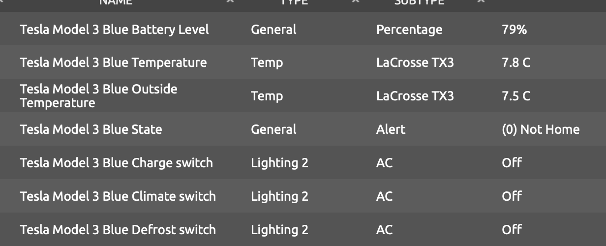

rgroothuis
Posts: 347
Re: New: Tesla hardware module
Post by rgroothuis »
MrHobbes74 wrote: Monday 23 March 2020 23:06 You can program domoticz to start charging after 9 (cheaper electricity) or to warm up the car in the morning before you leave for work. Or you can charge the car when it’s sunny and you have solar panels. There are many ways. You can keep graphs of the battery usage during the days weeks years. The module creates 7 devices, 4 for monitoring, 3 for controlling.
Thanks for the quick response. When I checked the Device page again I indeed now see the extra devices you are referring to. It makes more sense now. Thanks.
Screenshot 2020-03-23 at 23.10.13.png (88.77 KiB) Viewed 5437 times
Do you have example scripts available on how to program (in Lua I assume) the Tesla? For example to enable charging after 21.00 or when at 7.00 AM the temperature is below a certain level the heating is automatically enabled?

MrHobbes74
Posts: 115
Joined: Sunday 19 January 2020 22:29
Domoticz version: latest B
Post by MrHobbes74 »
No, I don’t have those yet. I’ve been working on the module, and now it’s rolled out, so I can start thinking of scripts. I’m planning to write a wiki with examples, but didn’t get the time yet to do it. I’m actually using dzVents for my scripting. If I may give one advise: put the default timeout to 20 minutes. That will enable the car to fall asleep. And to be able to control the charging, the car must be home, so you need to set it’s parked location (found in the logging) in the domoticz location.
