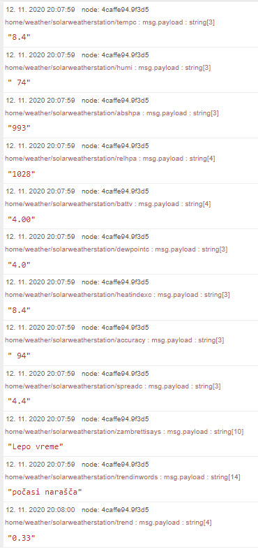

Hello.
This is a screenshot of the Debug node output, in the case of the "Topic" field: home/weather/solarweatherstation/#
"Lepo vreme" means "Nice weather" in Slovenian language.
At first I would be happy if I could get in Domoticz data of tempc, humi and relhpa in Domoticz sensor »temp+hum+baro«
Where should environment level and prediction come from, I don't know. Maybe let’s leave them for a begining.
All sensors a published at the same moment.
Roman

Hello Roman (@Lipa),
You wrote:
All of them are arriving at 20:07:59, except the last, which arrives at 20:08:00.
Totally 12 messages. We should remember.

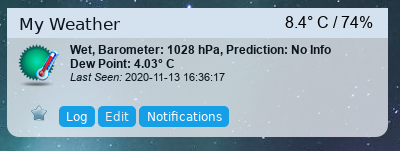

If everything has been done correctly, this is the result:

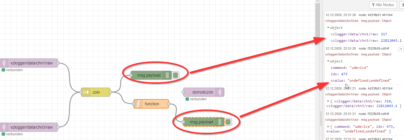

lazaruss72
- Posts: 17
- Joined: Thursday 14 December 2017 23:13
Re: Get sensor values with MQTT into Domoticz [Solved]
Hi @FireWizard,
you are my last great hope
I sit now for days on it and just do not come further.

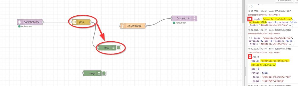

I always get only: svalue: undefined out. Somewhere I have an error, but I just can't find it. Maybe I am doing fundamentally wrong.
I have the hope that you with your knowledge simply say "Yes, there is the error, take this value and it works".

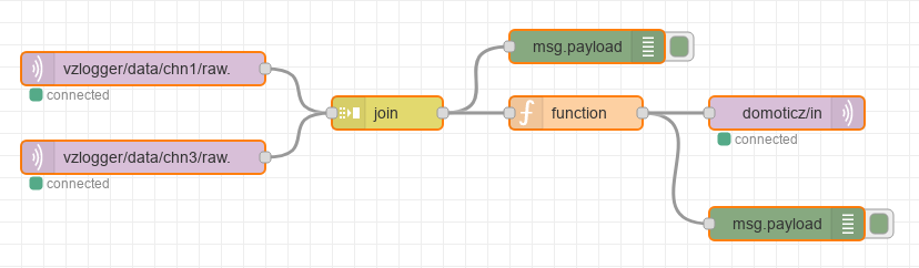

Here is my situation:
I collect data from my electricity meter via a Raspberry (vzlogger aka volkszähler) and output that there via MQTT. I have installed a MQTT broker and Node Red and everything works. For example, I can write to a text sensor via Node Red.
in the node mqtt in I see the data: in the json node also But no matter how I try, I don't get anything usable from the function node.
I don't really have a clue about JavaScript. i tried to understand your examples and adapt them to me, but it just doesn't work. with this code:
Can you tell me what i am doing wrong and how i can solve this?
The actual goal then is to get two values into my electric sensor.
The current consumption and the meter reading.
I really hope that you can help me, or someone else who has already implemented something like this.
many greetings
Marco
var us = msg.payload["domoticz/in/chn1/raw"];
var cu = msg.payload["domoticz/in/chn3/raw"];
msg.payload = {"command":"udevice", "idx":473, "svalue":us}
return msg;Can you tell me what i am doing wrong and how i can solve this?

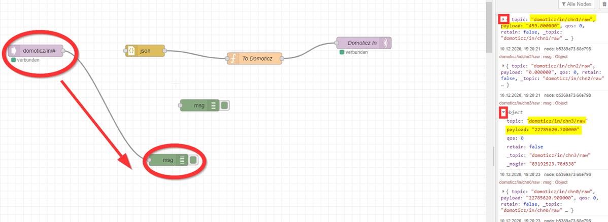

1. If I look to the output of your MQTT out node, I see you are subscribed to domoticz/in/#.
That does not look correct. You use as input everything that is sent to Domoticz. In fact you are looking to a loop. And Domoticz can not handle this data.
You said:
See: https://flows.nodered.org/node/node-red ... lkszaehler
I see discussions about MQTT support for vzlogger. If you use that (I assume you do) do you have info about the published topics?
Your topic is domoticz/in/chn1/raw and also chn0, chn2 and chn3.
However, I found somewhere on Internet that vzlogger publishes the data under topic: vzlogger/data/chn0/raw.
Can you confirm this?
2. The Domoticz sensor, you want to control.
Is this of type Electric?
If you can give me that information, I have a flow ready.

- FireWizard
- Posts: 1975
- Location: Voorthuizen (NL)
Hello @lazaruss72, Hello Marco.
If I look to your screenshots, I see that the value is a string. (the color is red and it is between " "). I see also that you have multiple channels (chn0, chn1, chn2 and chn3). Perhaps more, that I cannot see. I noticed you want to use the data from chn1 and chn 2.
I suggest the following flow:
As we have (at least) 4 channels, from which we want to use only 2, I propose not to use wildcards, like + or #, but to create 2 MQTT Input nodes with the correct topic. This avoids that we have to remove the other, unused topics, which may interfere with the correct stream.
The data is a simple payload with the value in a string. If it is a number we have to modify the "function"node slightly.
These two topics are joined in a Join node, where the topic (vzlogger/data/chn1/raw and vzlogger/data/chn3/raw) is used as the "key".
The result, you will see in the screenshot below.
These values are used in the function node to prepare the correct data to Domoticz.
The correct syntax is: {"command":"udevice", "idx":1234, "svalue":"us;cu"}.
The command "command":"udevice" is the default command and therefore may be omitted, but for clarity. I left it in.
You have to insert your IDX number for the sensor you use (electric)
The svalue has always to be a string value. In this case two string variable (us and cu), separated by a semicolon (;).
This is prepared in the function node.
If the data consists of a number (blue color and no " ") you have to make it as a string with the function as follows:

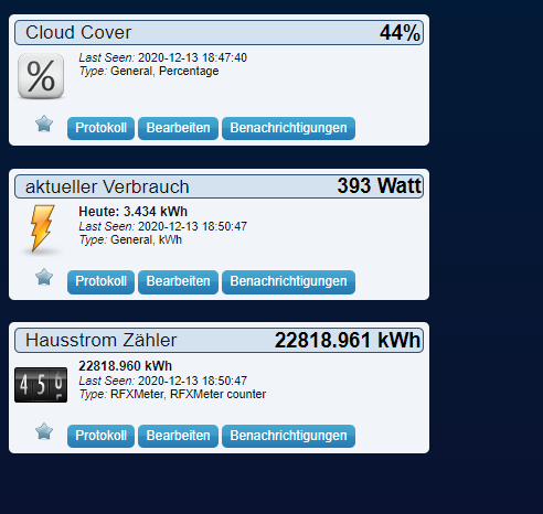

The result is as follows:
and will give you this values in the sensor:
I entered just some figures, so keep in mind that cu is cumulative and the values are added.
The input should be in Wh, although the presentation wil be in kWh.
Please find attached the complete flow:
Do not forget to insert the correct IDX number
Awaiting your result.
var us = msg.payload["vzlogger/data/chn1/raw."];
var cu = msg.payload["vzlogger/data/chn3/raw."];
msg.payload = {"command":"udevice", "idx":45, "svalue":us + ";" + cu};
return msg;Code: Select all
var us = msg.payload["vzlogger/data/chn1/raw."].toString();
var cu = msg.payload["vzlogger/data/chn3/raw."].toString();
return msg;and will give you this values in the sensor:
[{"id":"258d3ca4.36a2ec","type":"mqtt in","z":"b49db3af.cc9f8","name":"","topic":"vzlogger/data/chn1/raw.","qos":"2","datatype":"json","broker":"f9f13036.e28b58","x":250,"y":260,"wires":[["5afd9f35.aa70f"]]},{"id":"97ca8bf2.e3361","type":"function","z":"b49db3af.cc9f8","name":"","func":"var us = msg.payload[\"vzlogger/data/chn1/raw.\"];\nvar cu = msg.payload[\"vzlogger/data/chn3/raw.\"];\n\nmsg.payload = {\"command\":\"udevice\", \"idx\":45, \"svalue\":us + \";\" + cu};\nreturn msg;","outputs":1,"noerr":0,"initialize":"","finalize":"","x":640,"y":320,"wires":[["f352fb59.cd04f","d0e46a68.0d0e08"]]},{"id":"f352fb59.cd04f","type":"debug","z":"b49db3af.cc9f8","name":"","active":true,"tosidebar":true,"console":false,"tostatus":false,"complete":"false","statusVal":"","statusType":"auto","x":830,"y":422,"wires":[]},{"id":"d0e46a68.0d0e08","type":"mqtt out","z":"b49db3af.cc9f8","name":"","topic":"domoticz/in","qos":"0","retain":"false","broker":"f9f13036.e28b58","x":830,"y":320,"wires":[]},{"id":"5f929d20.09ce6c","type":"mqtt in","z":"b49db3af.cc9f8","name":"","topic":"vzlogger/data/chn3/raw.","qos":"2","datatype":"json","broker":"f9f13036.e28b58","x":250,"y":380,"wires":[["5afd9f35.aa70f"]]},{"id":"5afd9f35.aa70f","type":"join","z":"b49db3af.cc9f8","name":"","mode":"custom","build":"object","property":"payload","propertyType":"msg","key":"topic","joiner":"\\n","joinerType":"str","accumulate":true,"timeout":"","count":"2","reduceRight":false,"reduceExp":"","reduceInit":"","reduceInitType":"","reduceFixup":"","x":470,"y":320,"wires":[["4d33fb01.4811b4","97ca8bf2.e3361"]]},{"id":"4d33fb01.4811b4","type":"debug","z":"b49db3af.cc9f8","name":"","active":true,"tosidebar":true,"console":false,"tostatus":false,"complete":"false","statusVal":"","statusType":"auto","x":650,"y":262,"wires":[]},{"id":"f9f13036.e28b58","type":"mqtt-broker","name":"localhost","broker":"127.0.0.1","port":"1883","clientid":"","usetls":false,"compatmode":true,"keepalive":"60","cleansession":true,"birthTopic":"","birthQos":"0","birthRetain":"false","birthPayload":"","closeTopic":"","closeQos":"0","closePayload":"","willTopic":"","willQos":"0","willPayload":""}]Awaiting your result.

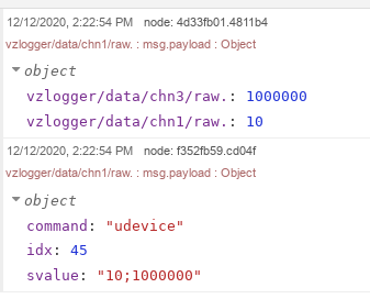

lazaruss72
- Posts: 17
Hello FireWizard,
thank you for your answer and the detailed explanations.
The two inputs and the join is completely ingenious.
I have tested your flow and unfortunately have to say that at the end comes out again undefined
As you can see in the screenshot below after the join at debug node both values occur.
But at debug node after the function arrives undefined.
I don't understand why ... your function looks very logical. i also tried it with the second code. there is the exact same thing
best regards
lazarus
best regards
lazarus
- FireWizard
- Posts: 1975
Hi, @lazaruss72
I see it. There is a dot behind the topic. No idea, how that has been introduced. Obviously introduced by me, during copy/paste.
I have now the following flow:
And the contents of the 'Function" node is now as follows, as it turned out to be a number and not a string:
var us = msg.payload["vzlogger/data/chn1/raw"].toString();
var cu = msg.payload["vzlogger/data/chn3/raw"].toString();
return msg;Awaiting your result.
lazaruss72
- Posts: 17
Hello @FireWizard,
You are absolutely amazing!
IT WORKS
I had seen the point at mqtt in node and corrected it, but it didn't occur to me to do the same in the function node. that's not where I noticed it.
I am so happy that it is finally working now!!! Many many thanks for that. Now I will put the second sensor into operation and hope that I can manage it.
Stay healthy and many greetings
lazarus

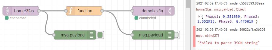

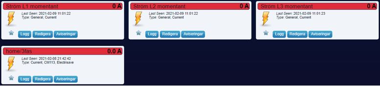

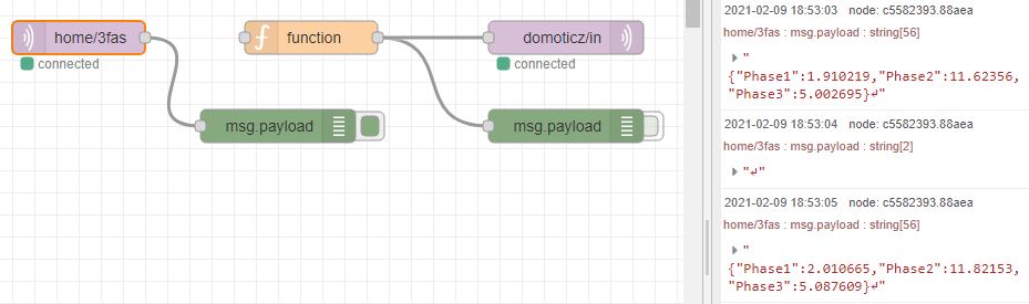

Hello Dear expert,
So sorry to trouble you with another noob at this...
I am trying to get measured current data to Domoticz (using EmonTX Shield for Arduino).
I have MQTT and Node-red up and running (I can see the Json data on the MQTT broker).
It looks like this: {"Phase1":xxx,"Phase2":yyy,"Phase3":zzz}
I did at a time manage to get updated values to the three 1-phase labels in Domoticz, but always with the (quite useless) value zero. In this picture they aren't updates at all.
Below is the flow with code from this helpful thread.
Hoping to get some help.
Thanjs in advance.
Br Richard
Thanjs in advance.
Br Richard
- Domoticz.JPG (30.12 KiB) Viewed 6065 times
- MQTT_to_Domoticz.JPG (50.7 KiB) Viewed 6065 times

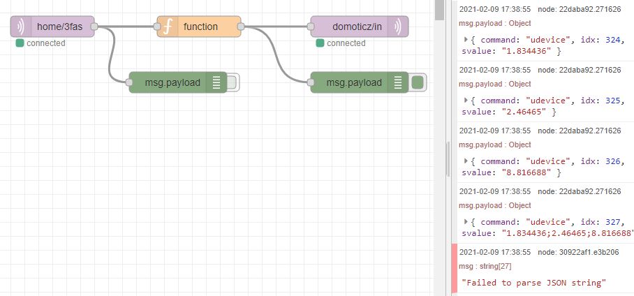

- FireWizard
- Posts: 1975
Hello @rippe

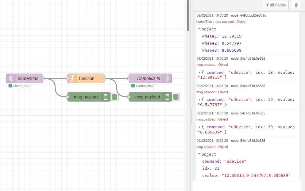

Dis you ever try to comment out the line starting with msg4? By putting // in front of it. And also remove msg4 between [[ ]]?
It should work.
But the problem is msg4.
What you do is that you send with msg 4, 3 complete message objects. You can see that after IDX 327 in the picture you send in your post.
What you want is to send the 3 values (ampere) of both Phase 1, Phase 2 and Phase 3 (separated by a semicolon
These values you will find back in msg1.payload.svalue, etc.
I modified your flow as follows:
I changed the IDX (18-21) numbers in order to test on my system.
This results in:
And in Domoticz:
Best regards
As far as I can see, the values for Current L1, CurrentL2 and Current L3 should update. The commands to Domoticz are correct.I did at a time manage to get updated values to the three 1-phase labels in Domoticz, but always with the (quite useless) value zero. In this picture they aren't updates at all.
It should work.
var msg1 ={};
var msg2 ={};
var msg3 ={};
var msg4 ={};
msg1.payload = {"command": "udevice","idx":18,"svalue": msg.payload.Phase1.toString()};
msg2.payload = {"command": "udevice","idx":19,"svalue": msg.payload.Phase2.toString()};
msg3.payload = {"command": "udevice","idx":20,"svalue": msg.payload.Phase3.toString()};
msg4.payload = {"command": "udevice","idx":21,"svalue": msg1.payload.svalue + ";" + msg2.payload.svalue + ";" + msg3.payload.svalue};
return [[msg1,msg2,msg3,msg4]]This results in:
And in Domoticz:
Best regards
Hi @FireWizard,
Jeeez... You are quick
Message 4 was much better.
However, Domoticz still will not update the values. Have a look at the picture. I believe it's somthing with the incoming string or something (see the parsing error).
Best regards,
Richard
Best regards,
Richard
- ParseError.JPG (49.77 KiB) Viewed 6056 times
- MQTT_to_Domoticz_3.JPG (35.14 KiB) Viewed 6056 times
- MQTT_to_Domoticz_2.JPG (67.01 KiB) Viewed 6056 times

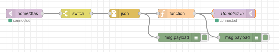

- FireWizard
- Posts: 1975
Hi, @rippe
It looks much better, but I really do not understand why the sensors are not updated.
If I take my values (and my input is exactly the same as yours) and configure the MQTT input node, to receive a string, then it gives me a string of 55 characters. The error you get, "Failed to parse JSON string" indicates a string of 27 characters.
But the output of your MQTT input node is a parsed JSON Object.
I assume that this error message is coming from this flow and not from another flow at another tab.
If you hoover with your mouse over the error message, does it indicate the MQTT input node?
If so, can you disconnect the MQTT input node from the "Function" node and change the Output to auto-detect.
Can you then make a screenshot of that first "Debug" node.
What I do not understand is why the sensors are not updated, while the commands are correct.
Question.
1. Is the MQTT out node correctly configured? (Is it pointing to same MQTT server as where Domoticz has subscribed to?)
Are there more MQTT servers?
2. Are the IDX numbers correct and do they match with the configured virtual sensors?
Let me know,
Question.
Let me know,
Hi @FireWizard,
Yes, doesn't it
It comes from the Arduino code and "StaticJsonDocument", so it should be correct (I suppose):
const int capacity = JSON_OBJECT_SIZE(3);
StaticJsonDocument<capacity> doc;
doc["Phase1"] = Irms1;
doc["Phase2"] = Irms2;
doc["Phase3"] = Irms3;
serializeJson(doc, Serial);
I have a lot of Flows, but showing messages only from the one currently opened. Hoovering over it indicates the incoming MQTT node.
Answer: There are more MQTT brokers, but I actually double checked now when you asked - it's the correct one
Answer: Yes, they are matching.
Please have a look at the attached debug message.
Best regards Richard
Yes, doesn't it
- MQTT_to_Domoticz_4.JPG (47.61 KiB) Viewed 6053 times
- FireWizard
- Posts: 1975
Hello @rippe
The problem is caused by the second message with a string, containing only a "carriage return" and this cannot be parsed by the MQTT input node.
This caused the message "Failed to parse JSON string"
In addition, I see also a "carriage return" at the end of the first string, but this one doesn't seem to cause a problem.
To prevent this extra string to give a fault message, we have to block the faulty string or allow the correct strings to pass.
I choose for the second option, as I'am not sure, if other faulty strings may occur.

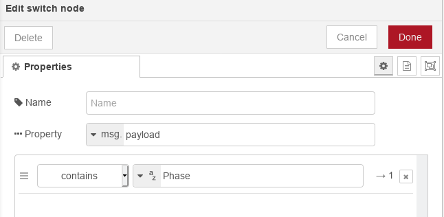

To do so:
1. Change the Output in the MQTT input node from "a parsed JSON object" to "auto-detect (string or buffer)".
2. Add a "Switch" node after the MQTT input node as follows:
Filter on "contains" and "Phase
That means that only strings, that contains the substring "Phase" will pass.
3. Add a JSON node after the "Switch" node. (As we removed the parsing in the MQTT node, we have to do it now.)
The flow will look as follows:
Can you test this and report back?
I did and I was able to simulate the problem.Please have a look at the attached debug message.
To do so:
