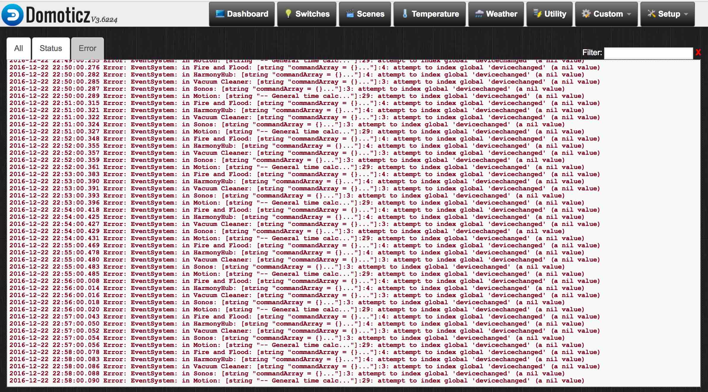

Does anyone have the solution for:
Even though it's happening for pretty much all scripts, here is my lua motion script:
I'm trying to work out why my scripts sometimes take a long time to execute (up to 5 seconds), my log is just getting filled with these errors non-stop, I've searched the whole forum but can't find what is causing it. I'm using the latest beta 3.6224 and this has been happening for a long time.2016-12-22 22:54:00.431 Error: EventSystem: in Motion: [string "-- General time calc..."]:29: attempt to index global 'devicechanged' (a nil value)

- Westcott
- Posts: 423
- Joined: Tuesday 09 December 2014 17:04
- Location: UK - Glos
Re: Script editor
Hi Ben53252642,
Is it a 'Time' script, rather than a 'Device' script?
That's invariably what "attempt to index global 'devicechanged' " means!
ben53252642
- Posts: 543
- Joined: Saturday 02 July 2016 5:17
Re: Script editor
It should be a device change script (that's the trigger) and then it references last changed times during the execution, but how to differentiate when script is stored in the database?
If it we're a file I would just call it "script_device_motion.lua", what is the equivalent for the database script manager?
I'm hoping getting rid of these errors might speed up the script execution times.
Last edited by ben53252642 on Thursday 22 December 2016 14:40, edited 1 time in total.

You're script is faulty.
If motion is on = light on
If motion is on and timediff > 900 = light on?
You can't combine a device and time script in one. In a time script the devicechanged table isn't available.
Edit for your last respone: in the dropdown list at the right: All/device/timee
