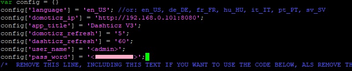

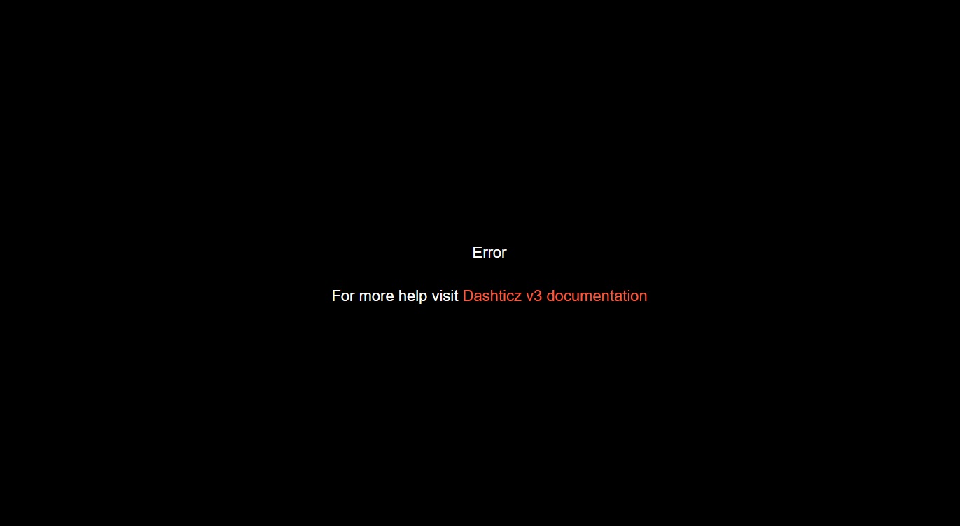

have just installed Dashticz, when I go to the web page it returns me "Error", configuration file it's correct and also docker is running, any help?
- Untitled.jpg (25.56 KiB) Viewed 1883 times

Are you sure the config.xml is OK?fabry91 wrote: Friday 18 December 2020 16:57 Hello,
have just installed Dashticz, when I go to the web page it returns me "Error", configuration file it's correct and also docker is running, any help?![]()

Re: Dashticz V3 - Automatic installation
You mean the config.js file? Yes, this is the config.js file:Sjonnie2017 wrote: Friday 18 December 2020 17:25fabry91 wrote: Friday 18 December 2020 16:57 Hello,
Oops! I should read more carefully!
I got only an error during the setup:
- install error.jpg (65.46 KiB) Viewed 1877 times
- setup.jpg (30.69 KiB) Viewed 1877 times

user_name and pass_word need to be without the '<' and '>' symbols.

Config.js indeed! I modified my Dashticz dashboards some time ago so I forgot the extension (and was too lazy to check before posting
I can't remember I had this error when I installed Dashticz on my Pi. But from what I read here (https://peppe8o.com/install-home-assist ... th-docker/) it does not have to be a problem (I am extrapolating.. I know).
What happens if you follow this guide: https://dashticz.readthedocs.io/en/mast ... board.html. It will only show your favorites from Domoticz but at least it is a start to see if the installation is OK. Just mark out the username and password lines and see what happens.
It was just that! Yeeee, thanks LokonliLokonli wrote: Friday 18 December 2020 18:10 user_name and pass_word need to be without the '<' and '>' symbols.
