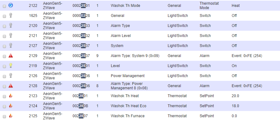

Hi all, I am using now the latest beta v4.10203 and try to make the Spirit Z work no results yet.
As of 27 October the Spirit Z is added to the OpenZwave MASTER 1.4 and a few days later is in the Config op Domoticz.
The problem is now and is really confusing that we have a lot of eur_spiritz.xml files now but what is the right one?
I have compiled v4.10203 with the patch of @w1||14am and delivers a lot more devices but it crash after a will.
In the OpenZwave MASTER 1.4 only the config files are there but not the patch for setpoint and that is maybe the problem.
The patch from @w1||14am is doing something with the setpoint but is not stable or I missed something to run in this beta.
So I am now using the eur_spiritz.xml which comes with Domoticz so that is the one from the MASTER 1.4 Whatever I change it is not working or a message in the log "Error: ZW_SEND_DATA could not be delivered to Z-Wave stack".
Has anyone a idea how to get this work beta?
Do we have to wait when the setpoint thing is implemented into the OpenZwave MASTER 1.4 or wait for 1.6?
I the picture I also see the device named "Furnance" what does this mean?

@knielen not yet,I tried several xml files but it’s not stable. setpoint not availble in Domoticz or Level not reliable.
Still not know which xml to use I should say what comes with latest Domoticz beta’s same as openzwave 1.4 master.
But we still have to change something but what we also some code for the setpoint I think.
