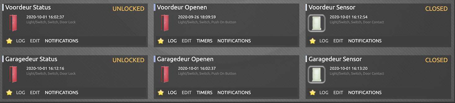

2nd lock installed and seems to be working fine (only up and running for 4 hours).
What is unclear for me is the installation comment:
Not sure how this can be installed/configured. Do I need to create/install two Nuki HW's? Currently I've one and both locks are added.Multiple bridges REQUIRE SEPARATE PORTS!!!
If not then the messages from one bridge will be sent to the plugin of the other and vice versa

This only applies if you have multiple bridges (eg one bridge or lock).
Basically, the bridge will send status updates for every lock to domoticz to the IP/port configured. When you have multiple bridges, you need to install multiple plugin instances with their own port to make sure that the messages all end up with the right plugin instance.
Verstuurd vanaf mijn SM-G980F met Tapatalk

Excellent, that clarifies it. Thanks. And well done for the good dev and support.heggink wrote: Thursday 01 October 2020 17:06 This only applies if you have multiple bridges (eg one bridge or lock).

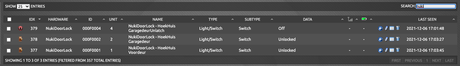

I've another problem with the Nuki plugin after a power-failure in my house:
Any suggestion what is wrong?
2021-12-06 16:21:10.735 Error: NukiDoorLock: (NukiDoorLock) 'onCommand' failed 'IndexError':'list index out of range'.
2021-12-06 16:21:10.736 Error: NukiDoorLock: (NukiDoorLock) ----> Line 420 in '/home/pi/domoticz/plugins/domoticz-nuki/plugin.py', function onCommand
2021-12-06 16:21:10.736 Error: NukiDoorLock: (NukiDoorLock) ----> Line 299 in '/home/pi/domoticz/plugins/domoticz-nuki/plugin.py', function onCommand
2021-12-06 16:21:30.134 Error: NukiDoorLock: (NukiDoorLock) 'onStop' failed 'AttributeError':'httpServerConn'.
2021-12-06 16:21:30.134 Error: NukiDoorLock: (NukiDoorLock) ----> Line 407 in '/home/pi/domoticz/plugins/domoticz-nuki/plugin.py', function onStop
2021-12-06 16:21:30.135 Error: NukiDoorLock: (NukiDoorLock) ----> Line 246 in '/home/pi/domoticz/plugins/domoticz-nuki/plugin.py', function onStop

Not really. This line retrieves the lock id.from the locks table but the number of locks is out of range. As if some data got corrupted with the power failure. If you dig deep, you may be able to find what's wrong but it's probably easiest to write down the settings for the nuki plugin, delete and recreate it.

Thanks for the quick response.
I deleted the Niki Plugin and added it again to Domoticz. That solves some of the problem, I can control the lock again. But I'm missing some switches.
Previously I had two switches that showed the lock status, if the door was open or not. I don't have them now anymore! Did I do something wrong?
For each lock there were 3 switches created, 1) Door Status, 2) Lock/Unlock door, 3) Open the Door.
But I only have 2 now.

Is this using the same plugin version?
Remind me again which version of the lock you have: with or without door sensor?

I've two Nuki door locks with the door sensors and the bridge of course.heggink wrote: Wednesday 08 December 2021 0:16 Is this using the same plugin version?
Sent from my SM-G980F using Tapatalk
The plugin I'm using is the same as from Github. From the config file: url = https://github.com/heggink/domoticz-nuki
Does this info helps?
