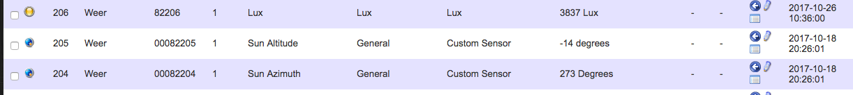

Still having problems with this script
2017-10-26 10:36:00.952 Error: dzVents: Error: SOLAR 2.1.1: There is no device with that name or id: 204
2017-10-26 10:36:00.952 Error: dzVents: Error: SOLAR 2.1.1: An error occured when calling event handler Solar Data
2017-10-26 10:36:00.952 Error: dzVents: Error: SOLAR 2.1.1: ...icz/var/scripts/dzVents/generated_scripts/Solar Data.lua:300: attempt to index a nil value

O, didn't see the newest version out

EdwinK wrote: Thursday 26 October 2017 10:54 O, didn't see the newest version out
OK, then after upgrading...
1) Did you define a cloud cover device?
2) Is it a percentage device?
3) Make the script output some debug messages. (

Ah... Oaky. Just did a check and it seems that on the Synology version we are still on 2.2.0. Guess I'm out of luck for now, until Jumbotroll releases a new version of domoticz and that will only be after there is a new stable version ;(
