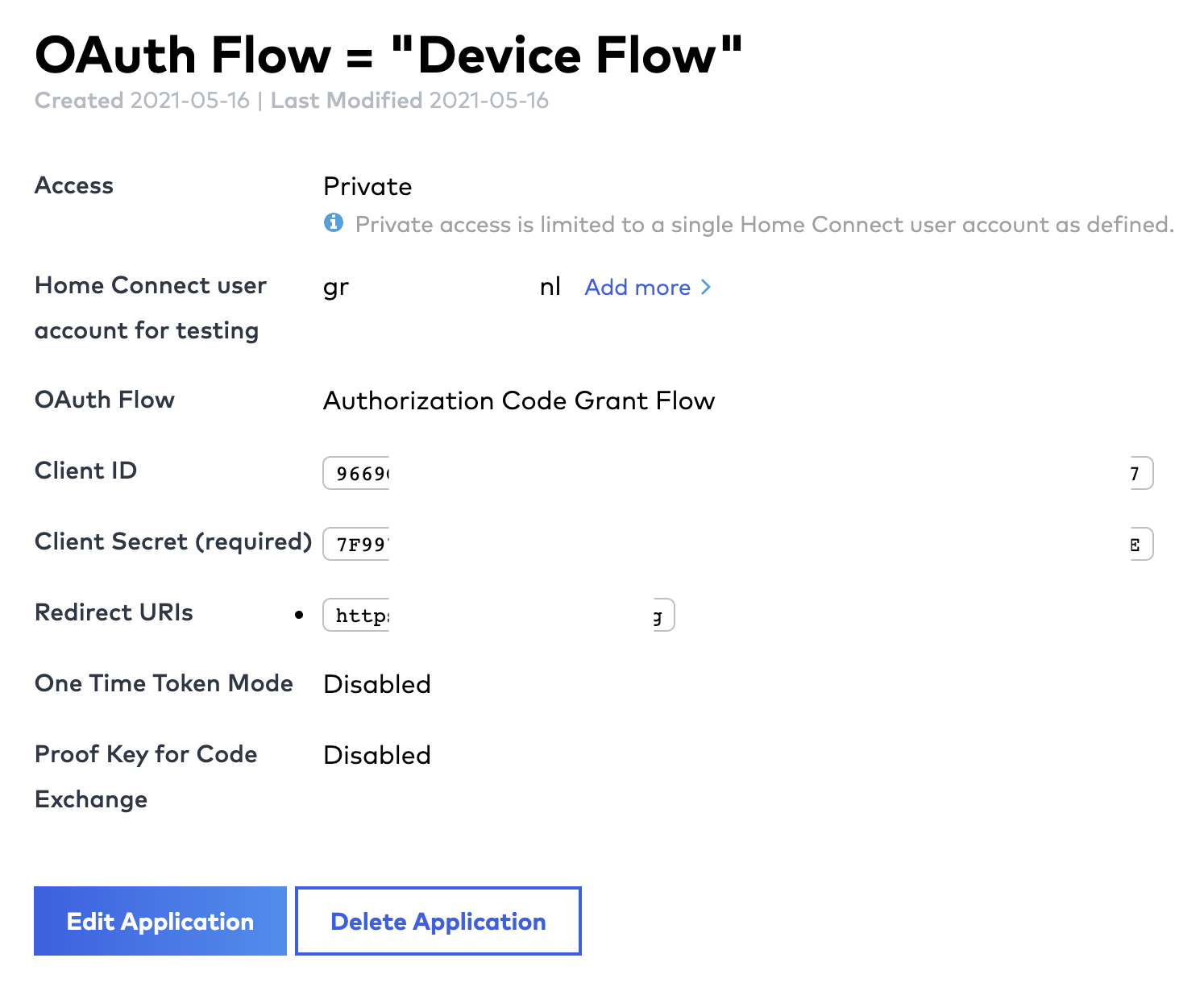

Just checking, maybe somebody can confirm if I filled in the Siemens connect dev API correctly, see screenshot?
What do I need to fill in for the redirection URL?

What I don't understand is how to connect my Dishwasher into the account that I've created at https://developer.home-connect.com/! How do I connect my Dishwasher into this account? Any suggestions?
The errors in Domoticz are still:
2021-05-17 22:02:44.121 Error: (Dishwasher) Device "" is not authorized by Home_Connect.
2021-05-17 22:02:44.321 Error: (Dishwasher) 'onStart' failed 'TypeError':'string indices must be integers'.
2021-05-17 22:02:44.321 Error: (Dishwasher) ----> Line 459 in '/home/pi/domoticz/plugins/Domoticz-Home-Connect-Plugin/plugin.py', function onStart
2021-05-17 22:02:44.321 Error: (Dishwasher) ----> Line 95 in '/home/pi/domoticz/plugins/Domoticz-Home-Connect-Plugin/plugin.py', function onStart
2021-05-17 22:02:44.321 Error: (Dishwasher) ----> Line 91 in '/home/pi/domoticz/plugins/Domoticz-Home-Connect-Plugin/homeconnecthelper.py', function gethaId
In the installation steps it is stated: "Register an application with the following parameters: ** OAuth Flow = "Device Flow"" what name do I need to fill in for the Device Flow? Or is this the actual string that I need to exactly copy when I'm registering? See also screenshot above.
So I guess that somehow to link to my Dishwasher is not setup correctly. I review all the install steps and cannot find what is wrong. Any suggestions?
If anybody can help me on this it would be appreciated. Even suggestions on how to debug this issue would be great. Thanks.

Thanks for the feedback. Indeed of the plugin is not maintained it is an issue.
How did you add the Siemens/Bosch device into the developer API account? THat is something I don't understand. Maybe that is the only issue I'm having. If that is solved, maybe the plugin is working.
I created an account, created an application etc, see also screenshot above. But I was not able to add my dishwasher into that account. Somehow you need to link the DishWasher at home into that account, correct?

Decided to delete the application etc in the Siemens portal and redo the config. Seems that I'm one step further, this is the error code/logging now:
2021-05-19 15:48:06.415 Status: (Dishwasher) Started.
2021-05-19 15:48:07.139 Status: (Dishwasher) Initialized version 3.2.1, author 'Mario Peters'
2021-05-19 15:48:07.138 Status: (Dishwasher) Entering work loop.
2021-05-19 15:48:09.029 Error: (Dishwasher) 'onStart' failed 'TypeError':'string indices must be integers'.
2021-05-19 15:48:09.029 Error: (Dishwasher) ----> Line 459 in '/home/pi/domoticz/plugins/Domoticz-Home-Connect-Plugin/plugin.py', function onStart
2021-05-19 15:48:09.029 Error: (Dishwasher) ----> Line 95 in '/home/pi/domoticz/plugins/Domoticz-Home-Connect-Plugin/plugin.py', function onStart
2021-05-19 15:48:09.029 Error: (Dishwasher) ----> Line 91 in '/home/pi/domoticz/plugins/Domoticz-Home-Connect-Plugin/homeconnecthelper.py', function gethaId
Next is I will check the lines 459, 95 and 91 to see if I see something strange.

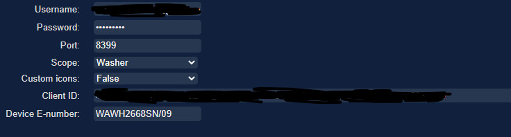

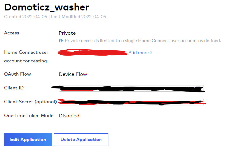

So register an account at https://developer.home-connect.com/
create an application
in domoticz create harware with the home connect plugin
username/pwd should be the username in the app (not in developer.home-connect.com)
port number is your choice, I did choose 8399 for the washer hardware (matching below)
I cloned the homeconnectSSE.sh file to homeconnectSSE_washer.sh
following line should be edited
PYTHON_PATH=/usr/bin/python3
DIR=/home/teha/domoticz/plugins/Domoticz-Home-Connect-Plugin
DAEMON=$DIR/homeconnectSSE.py
DEVICE_NAME=Washer
DOMOTICZ_IP=YOUR_DOMITICZ_LOCAL_IP
DOMOTICZ_PORT=8399
DAEMON_NAME=homeconnectSSE_$DEVICE_NAME
DAEMON_LOG=/home/teha/logs/$DAEMON_NAME.log
# This next line determines what user the script runs as.
# Root generally not recommended but necessary if you ar using the Raspberry Pi GPIO from Python.
DAEMON_USER=YOUR_USER_THAT_RUN_DOMOTICZ
copy homeconnectSSE_washer.sh from plugin to /etc/init.d
sudo update-rc.d homeconnectSSE_washer.sh defaults
sudo service homeconnectSSE_washer.sh start
restart domoticz
restart homeconnectSSE_washer.sh
last lines in the /home/USERNAME/logs/homeconnectSSE_Washer.log should now be some access token and then there will be a new line everytime domoticz make a call to the sseclient
maybe I skipped some of the steps with regards to instalkling python, python3, pip, pip3 and sseclient
hope this helps (remember this is for ubuntu and not for raspberry pi)
One more thing!
If you install the hardware in Domoticz and doing "update" on the harware and you get some data in to the devices (as your bosch device is running) but you don't get any continous updates, this is an indication on the everything is OK at https://developer.home-connect.com/ and also in Domoticz, however there is some problem with the communication to the sseclient, look in the logs at /home/USER/logs/xxxxx.log

Finally managed to fix the issue.
Important is to use an OTHER PORT!! in the plugin as the Domoticz port
file plugin.py:
