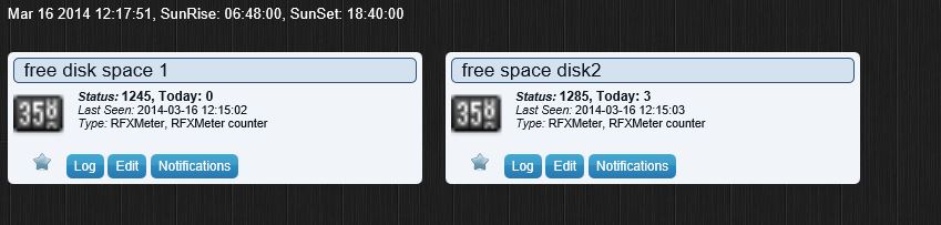

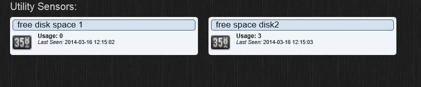

Re: HowTo: monitor Synology NAS
sorry mbliek i thougt there was, as far as i know now there is only one power status in Synology SNMP: good or fail (well i know when it fails
i still have one other issue.
free space giving me the good status on the utility page
but on my room page it gives me a 0 or 1 or 2.
and i cannot figure out why.
here is my script (free space has IDX 45 and 46)
if someone know why, please tell me i'm a little stuck here...

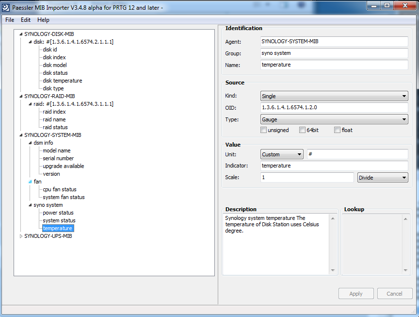

I have turned on SNMP on my DS213+,
when I try to snmpget data from the device, I receive the following error:
are there any recent oid changes ?
root@archimedes:~# snmpget -c public -v2c -O qv 192.168.0.15 .1.3.6.1.4.1.6574.1.2.0
No Such Object available on this agent at this OID
root@archimedes:~#

@theezeefje could it be you forgot space between -v and 2c ? The oid is for system temperature and shoul work on a Sinology
