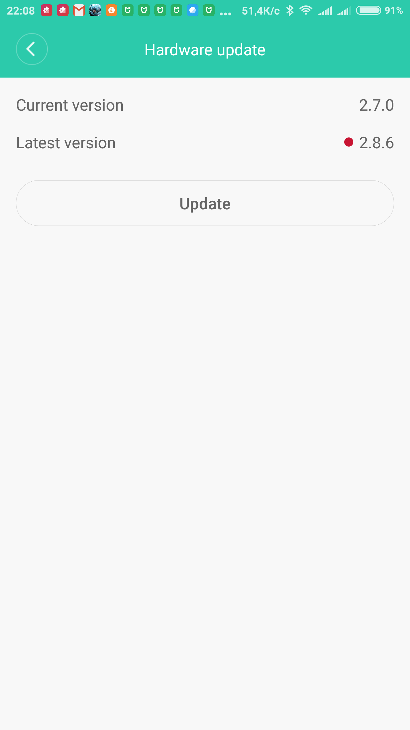

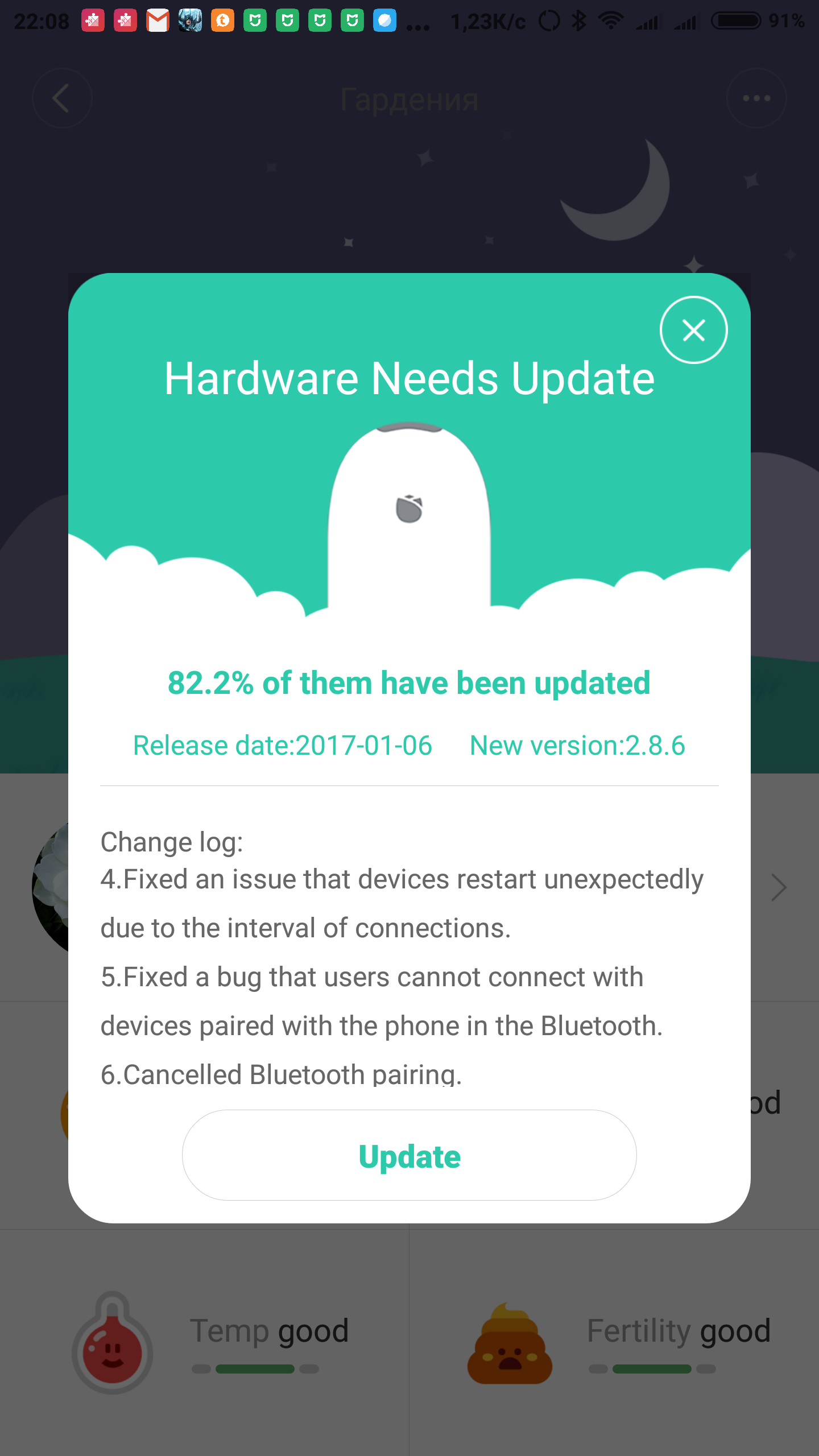

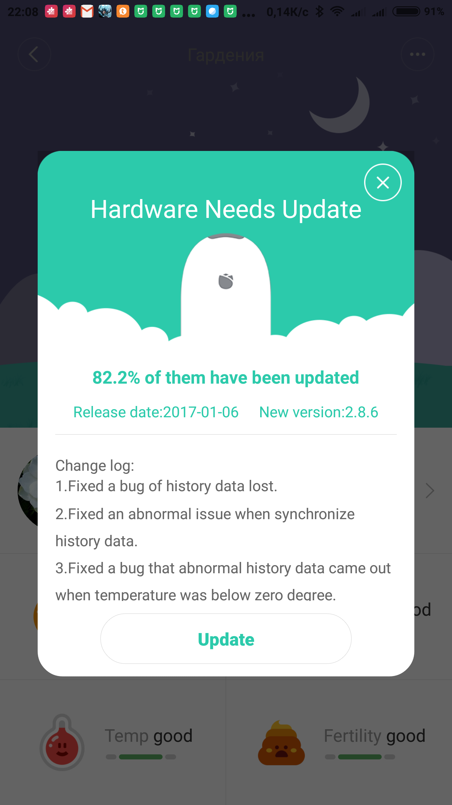

Update 2.8.6 date: 2017-01-06
Change log:
1. Fixed a bug of history data lost.
2. Fixed an abnormal issue when synchronize history data.
3. Fixed a bug that abnormal history data came out when temperature was below zero degree.
4. Fixed an issue that device restart unexpectedly due to the interval of connections.
5. Fixed a bug that users cannot connect with devices paired with the phone in the Bluetooth.
6. Cancelled Bluetooth pairing.
