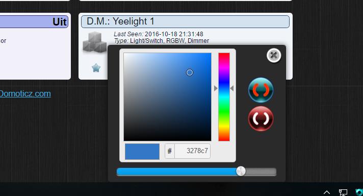

corbin
Posts: 463
Location: Brisbane, Australia
Re: Help with Yeelight Bulb
Post by corbin »
Derik wrote:Works great....
ALL..
Just order a strips and a other bulb to test....
Love you guys GREAT work...
Great!
Did you get it working on your pi also?

TwoEasy
Posts: 13
Joined: Friday 09 September 2016 18:29
Post by TwoEasy »
corbin wrote:
Derik wrote:
TwoEasy wrote:
Yep, bulbs are i n dev mode but it doesnt actully work to add the hardware Yeelight led in domoticz so it can find the bulbs
What board are you using??
And the beta Version? [ last needed.. ]
Yeah you don't have the latest beta or your web browser cache hasn't refreshed if you can't see Yeelight LED to choose under hardware
Beta version 3.5786
Raspberry pi 2
Can see the Yeelight hardware plugin but when I press add, the hardware plugin is not being added, nothing happends
Edit: Worked when I tried to use Microsoft Edge instead of Chrome!

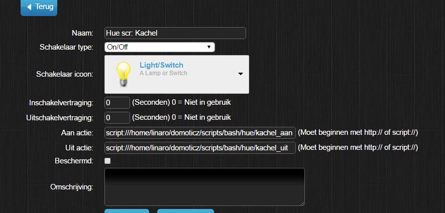

Now the next challenge.
The yeelight operate with a http script like the hue.
#!/bin/sh
curl -H "Accept: application/json" -X PUT --data '{"on": true,"bri": 168,"hue": 14135,"sat": 254,"xy": [0.5281,0.4302],"ct": 500,"alert": "none","effect": "none","colormode": "hs","reachable": true}' http://192.168.5.36/api/newdeveloper/lights/8/state
curl -H "Accept: application/json" -X PUT --data '{"on": true,"bri": 168,"hue": 14135,"sat": 254,"xy": [0.5281,0.4302],"ct": 500,"alert": "none","effect": "none","colormode": "hs","reachable": true}' http://192.168.5.36/api/newdeveloper/lights/9/state
For 2 yellow lights
And:
#!/bin/sh
curl -H "Accept: application/json" -X PUT --data '{"on": true,"bri": 42,"hue": 45643,"sat": 252,"xy": [0.1849,0.0749],"ct": 500,"alert": "none","effect": "none","colormode": "xy","reachable": true}' http://192.168.5.36/api/newdeveloper/lights/8/state
curl -H "Accept: application/json" -X PUT --data '{"on": true,"bri": 42,"hue": 45643,"sat": 252,"xy": [0.1849,0.0749],"ct": 500,"alert": "none","effect": "none","colormode": "xy","reachable": true}' http://192.168.5.36/api/newdeveloper/lights/9/state
For 2 white lights
And switching with a dummy:
The reason you can work with a standard color via a script, when the light turn on.
Now put you the light on in the previous setting, but the best option for me, if you turn the light on you can choose it to your desired color.
Then, someone now how the disco function works?

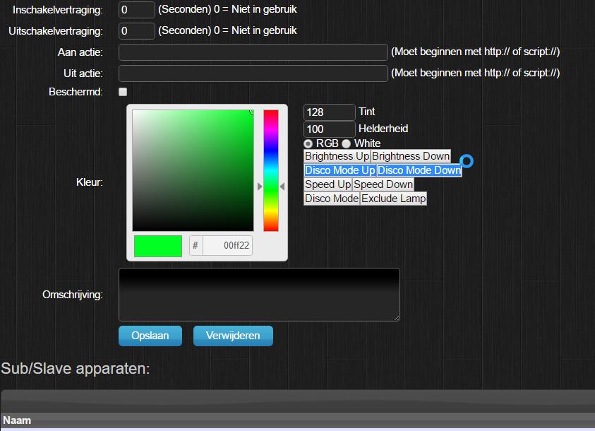

corbin
Posts: 463
Post by corbin »
Hi Derek,
I've been adding in some of those missing functions tonight. With the disco mode, what would you like the color bulb to do for this function?
Derik
Posts: 1605
Post by Derik »
corbin wrote:Hi Derek,
mwhaaa when you can fix that...
Disco go to different colors after x seconds and set the time fast and slow...
like:
https://www.youtube.com/watch?v=WjXzdmjPMhU
or all the things you can make...:-)
corbin
Posts: 463
Post by corbin »
making it play set patterns is ok, I just need some patterns!
You can try this from the terminal, works on Linux, not sure on Raspberry - you will need to change 192.168.5.14 to the IP of your bulb:
echo -ne '{"id":1,"method":"start_cf","params":[ 50, 0, "50, 2, 5000, 100, 50, 2, 5000, 1"]}\r\n' | nc -w1 192.168.5.14 55443

I'm a developer from Yeelight and I'm so glad that many people here like Yeelight bulbs!
I saw some questions regarding the "Sunrise" and "Sunset", actually, it's just implemented using "start_cf" command. With this command, you can achieve almost any effect you want.
For example, set following command to bulb and you will see "sunrise" effect:
{"id":1, "method":"start_cf", "params":[3,1,"50,1,16731392,1,360000,2,1700,10,540000,2,2700,100"]}
Please refer to the inter-operation spec (page 12) for detailed explanation.
BTW, if your bulb is in OFF state, use "set_scene" command instead of "start_cf", which is to turn on the bulb firstly and then start color flow effect.
-Wilson

weiweipossible
Posts: 10
Joined: Wednesday 19 October 2016 13:09
Location: Qingdao, China
Post by weiweipossible »
Hi Derik,
Nice to know you! About the disco mode, the bulb actually exposes an interface that can be used to do that. As I have once explained in Yeelight forum, the music to color transformation should be done by the control side, but unfortunately, I don't have that knowledge :) , but I do believe that there are already some algorithm can handle that. The basic idea is to map some frequency to color and map the volume to brightness.
-Wilson
The differences between music mode and normal mode is that there is no command quota and no property change reported.
The set_music command is to enable the music mode, once received the command, the bulb will act as a TCP client to connect to the server specified in the parameter and from then on, the server can send any commands to the bulb. The music-to-light transformation part should be done by music server (normally use FFT).
Our android app just implements the music-to-light transformation algorithm and send the command to the bulb. User's android phone is acting as the music server.
Under music mode, the bulb acts as the client side because it's a bit easier for music server to play music to multiple bulbs at the same time.
