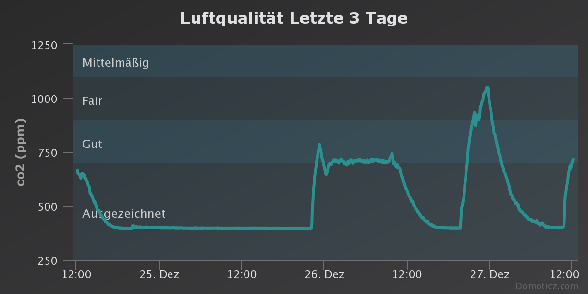

Dear all,
regarding the calibration from my testing it is also possible to switch on the ABC normal for e.g. 24 to 48 hours, best case nobody is at home during that time. If the ventilation was very good before or inbetween, then the lowest values will be adjusted to 395 ppm. Afterwards it is possible to switch off ABC normal again. The calibration will not Switch back. Therefore you do not need to calibrate outside or with a special gas. It seems to be pretty reliable. We are using automatic ventilation system with heat recovery, where air inside a room is refreshed 2-3 times within 24 hours.
My graph is now looking like this:
Kind regards
Domoticz Beta | Aeon Labs Z-Wave USB Stick Gen5 | Cyrus SmartHome 4-in-1 Multisensor | Qubino ZMNHCD1 - Roller Shutter | NEO COOLCAM NAS-WR01ZE Power Plug | Fibaro FGRGB-101 | WEMOS D1 MINI (ESP8266) Sensors CO2/TEMP/BARO |

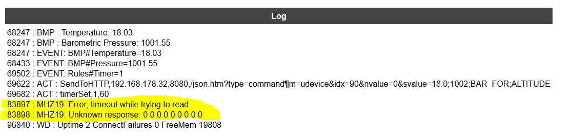

Hello Nixalschrott,
Ein Schönes Neujahr ;-)
I have the same error messages as you with my MHZ19.
I ordered a new one with no result.
I just followed all the steps in the instructions.
Also I changed the GPIO's in GPIO15 and GPIO13.
Using latest version ESP_Easy_v2.0.0-dev13_test_ESP8266_4096
Still no result ;-(
Can you, or an other one who read this mail please help me?
Regards, Thomas

The error you get means that it doesn't receive any data back from the MHZ19 after it has send the command for the current status.
So it should be either something with the GPIO settings ( Maybe wrong way around?) or the wiring unless you unit is broken.
Jos

Mhz19 working now! I flashed a new ESP12 with only the Mhz19 connected.
(flash was latest Mega version)
Stupid beginners fault, I changed Tx and Rx didn’t see that all that time!
