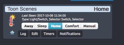

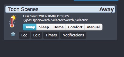

Tried to change Toon Scenes from Domoticz Switches from Home to Away, but after about 1 minute the system is back to Home? So there is something wrong with the script but what?
Toon switches  reads home standard<br />Home  standard
Home standard
Schermafbeelding 2017-10-09 om 11.32.49.jpg (25.8 KiB) Viewed 3688 times
changed it 11:33 to away
Schermafbeelding 2017-10-09 om 11.33.12.jpg (22.86 KiB) Viewed 3688 times
11:34 it is changed to home from itself
Schermafbeelding 2017-10-09 om 11.34.24.jpg (22.76 KiB) Viewed 3688 times

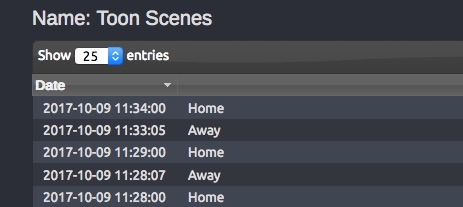

And here the fourth file (log file) i could not post it in the last file).
log file
log file
Schermafbeelding 2017-10-09 om 11.36.40.jpg (26.51 KiB) Viewed 3688 times

Walberg,
It looks like the command to change the scene never reached the Toon.
Every minute the script runs to synchronise the changes from Toon to domoticz, so when this script runs after 1 minute the scene selector is back to Home.
The best way to test this is to press the selector switch in Domoticz while you are standing in front of your Toon. Confirm that you see the scene change on your Toon. I'm guessing it doesn't!
So if I'm right the problem is in the scene selector. Did you include the right triggers to this selector? IS the IP Address of your Toon correct?

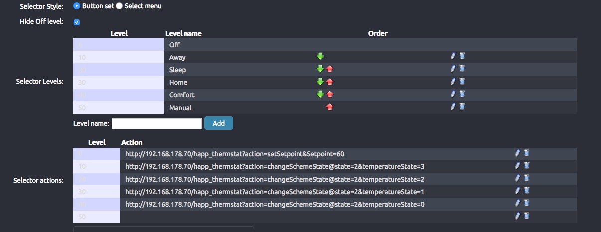

Yes your right, only Toon auto program is working (Switches when i am with ipad in front of Toon). But thermostat scenes and Program does not work.
Beneath my settings when edit Toon Scenes
Toon Scenes
Toon Scenes
Schermafbeelding 2017-10-09 om 14.45.13.jpg (94.44 KiB) Viewed 3668 times

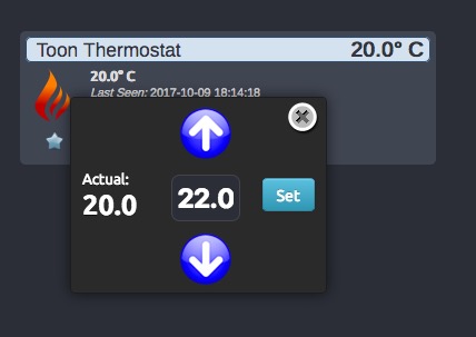

Toon setpoint
Toon setpoint
Schermafbeelding 2017-10-09 om 14.46.10.jpg (27.57 KiB) Viewed 3668 times
Maes
Posts: 34
Joined: Tuesday 05 April 2016 20:45
Re: Controlling Toon [HACKED] from Domoticz
Post by Maes »
Yo,
Look at your screenshot and my screenshot ;) ;) ;)
You are using @ instead of &
walberg
Posts: 46
Joined: Thursday 28 May 2015 18:41
Domoticz version: 3.5877
Location: Diemen Netherlands
Post by walberg »
aaahrgg, I have seen these rules with the original several times, also with the Toon Auto program, which of course was good. Always looking at my own mistake. The switches now work. Thanks. Only the thermostat setting ToonThermostaat still does not work.

What's going on with ToonThermostaat?
Post screenshots / etc
walberg

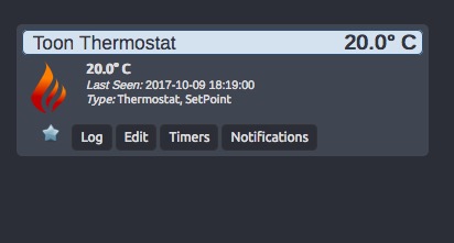

Posts: 46
Post by walberg »
When pushing flame you got the arrows up en down but setting temperature change only for a few seconds on the dummy but not the setpoint on the Toon (printscreen of my VNC) by example setting temperature at 22 after a few seconds return to 20 on the Domoticz screen but at the VNC screen (= Toon) nothing changed.
change temperature
change temperature

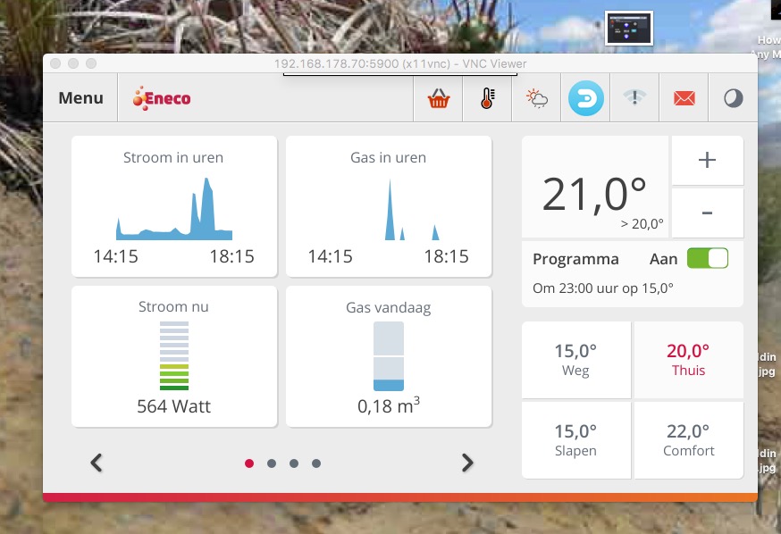

On Toon the temperature Still stays 20

after a few seconds  the Dummy gives 20 again

And here my dummy
Toon Thermostat
Toon Thermostat
Schermafbeelding 2017-10-09 om 18.20.09.jpg (26.16 KiB) Viewed 3651 times
