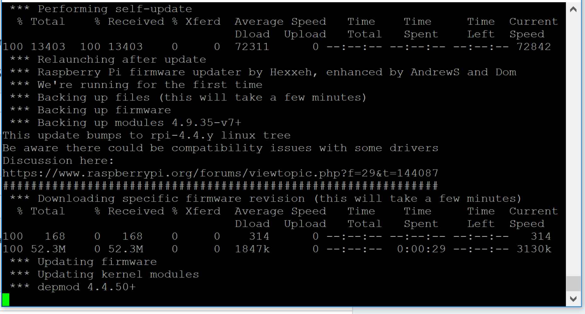

Does anyone else is having issues with pmaxd? It just stopped working at some point. I rebuild a new image to test, but also that one doesn't work. Everything is running as it should, but there doesn't seem to be a connection between the PI and the visonic. When I run it manually it just stops at ' Sarting Main loop...'
I tested even with a different PI, no difference. Tested with the serial connector linked to a windows pc, and from there everything worked.
Can it be that xPLL_Hub has changed?
BornToKill
- Posts: 15
- Joined: Sunday 18 September 2016 9:41
Re: Step by step guide: Visonic Powermax Pro integration
Same here since rpi-update has been done....
Investigating..
Investigating..
jelleeelco
- Posts: 61
- Joined: Wednesday 04 January 2017 15:25
Pfew, so glad you're replying... I think I have done the same thing (rpi-update) and of course with a new build it's the same...
Really can't figure out what's wrong... this is above my knowledge. It looks like the xPL is not communicating, but it's a wild guess.
BornToKill
- Posts: 15
OK,
So kernel 4.9.X broke something.
To downgrade 4.4.50 : rpi-update 52241088c1da59a359110d39c1875cda56496764
Reboot !
Enjoy
PS : I'm on Jessie (Raspbian)
Reboot !
Enjoy
Ok. Thanks to BornToKill it's sorted. As he said, the kernel update must have broken something. I don't know how I performed the kernel update, as the instruction rpi-update was not available.
So, this is what I did (well, what BortToKill asked me to do....and it worked). SSH into the pi and then:
(outcome should be Raspbian GNU/Linux 8 \n \l which means running Jessie)
This gives the kernel currently running, mine was: Linux raspberrypi 4.9.35-v7+ #1014 SMP Fri Jun 30 14:47:4
I didn't have rpi-update installed, so first I installed that:
and then downgrade the kernel by being root user:
Then reboot and it worked!
All credits to BornToKill, I just followed his instructions via the email.
cat /etc/issue
uname -a
apt-get update
apt-get install rpi-update
sudo su
Thanks guys
After an uptime of 6 months, I thought, maybe a good idea to update the pi to the latest version. Not....
Kernel 4.9 kills the pmaxd!!
So did; rpi-update 52241088c1da59a359110d39c1875cda56496764
And it's up and running again. Cool
- Knipsel.jpg (129.82 KiB) Viewed 8844 times
