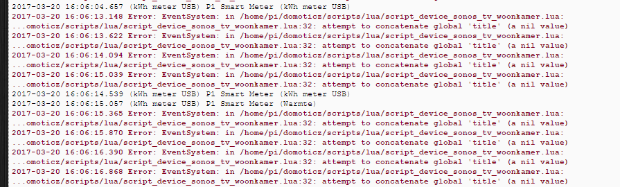

I changed the lua to yours.
I changed:
- ip to the ip of my domoticz (http://10.100.75.113:5005/woonkamer/state)
- line 32, i changed badkamer to Woonkamer/Eetkamer
I get this message in de log:
2017-03-20 08:06:16.879 Error: EventSystem: in /home/pi/domoticz/scripts/lua/script_device_sonos_tv_woonkamer.lua: ...omoticz/scripts/lua/script_device_sonos_tv_woonkamer.lua:32: attempt to concatenate global 'title' (a nil value)
Is the number "32"' the line where the error is?

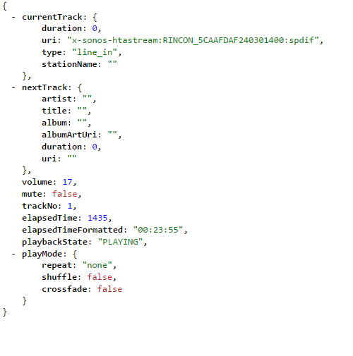

2017-03-20 16_04_23-10.100.75.113_5005_woonkamer_state.png (20.37 KiB) Viewed 9383 times
2017-03-20 16_03_58-Domoticz.png (49.84 KiB) Viewed 9383 times

I found out that the error is only when the sonos is active. If it is in pause, there is no error.
The switch is not reacting to the sonos. It stays in pause.
Can anyone tell me how to resolve this?

The reason that it errors out is that your stream or mp3 does not contain any meta data.
About the selector switch, the first value should be changed into your idx of the sonos switch
