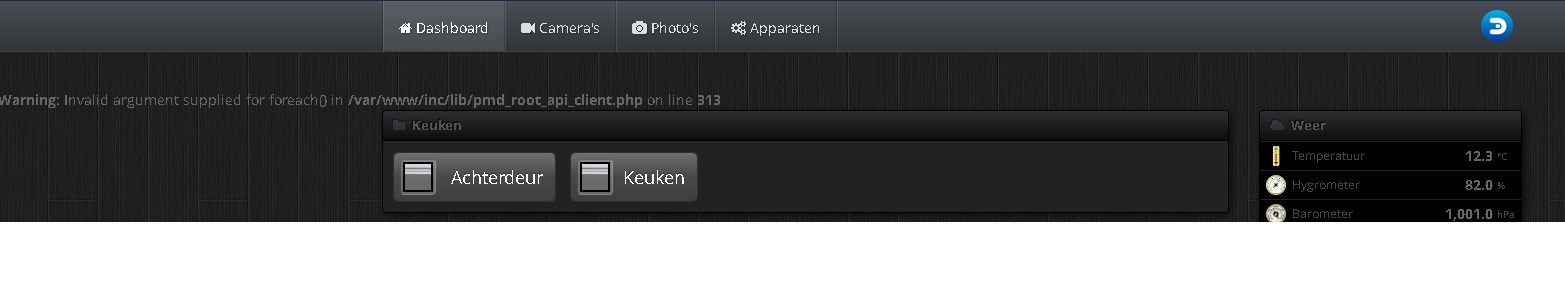

Post by capman »
Why get a get this warning (see screenshot) when a set debug to 1 in the config file ?

Post by wxop »
capman wrote:Why get a get this warning (see screenshot) when a set debug to 1 in the config file ?
It seems weird. You also seems to have a font display problem (according to your sceenshot)... Compare with the online demo at
http://www.phpmydomo.org/demo/www/
You might try to clear the cache by going to
http://PMD_IP/utils/reset
