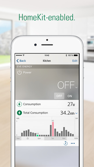

I have one question: it is possible to get the charts in Eve app like screenshot on the web page?
https://itunes.apple.com/app/elgato-eve/id917695792
screen322x572 (1).jpeg (34.86 KiB) Viewed 6673 times

makuta77 wrote:Hello,
It's great job!!! Works like a charm!
Thanks! And hopefully, in a future patch. I know _how_ it's done.
Homebridge needs the v.latest version of the hap-nodejs submodule: do-able, pull the plugin-2 homebridge repo, but better to wait for it to be merged into stable/master as unstable at the moment. That provides the ‘log’ characteristic. Then either Elgato will handle that characteristic if it detects it, or it’ll need linking in via elgato-specific charateristics
The crux of the issue is that I need to be able to retrieve the log points from Domoticz and I don't think they're officially exposed via the json api. I need to look at the Ajax requests for the sensor log views in Domoticz and see if I can fudge it somehow.
Edit: Found them...
http://127.0.0.1:8080/json.htm?
		type=lightlog
		&idx={_ID_}
		type=graph
		&sensor={counter|Percentage|temp|rain|fan|wind|uv}
		&idx={_ID_}
		&method={int}
		&range={day|week|month|year}
			&actmonth={month}
			&actyear={year}
It's definitely something I'd like to support if I can work out how, and will be a milestone to aim for. Watch this space!
