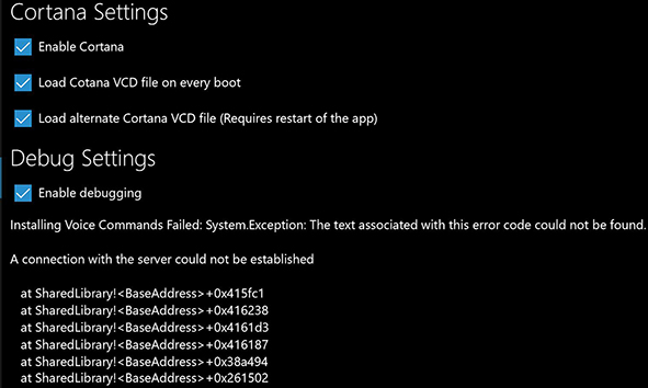

Can confirm the working of the motion sensors. Got an error in debug: Don't know what it means but speech is still working though. Cortana and I are getting more and more acquainted
so commands are getting a follow up now. Thanks for a good job.

@Doler You can safely ignore that error for the moment, the VCD file is updated every time the app starts, but really only needs updating when I add commands.
Thx for the testing!
