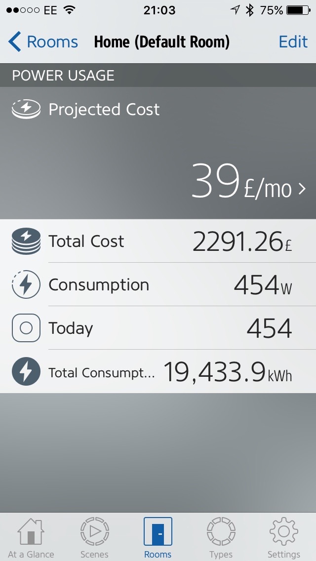

Marci wrote: Am freezing addition of new features to the Master branch as I get the feeling we’ll be making MQTT-integration the default Release version sooner rather than later.
mine has been OK, except i had an issue where it wouldn't respond at all, even ssh to my pi wouldn't work.
i wasn't too bothered and then later it just started working... on another point, the Youless code seems a bit weird.
the "Today" item seems to reflect the "Consumption" item, both changing together.

the "today" item is still in sync with the consumption but now shows kwh after it
Domoticz 3.5641 on RPI (Raspbian GNU/Linux 8)

So needs /1000, yes? Eg: 800w becomes 0.800kW
(kWh is the 'correct' unit)
Edit: ignore, just seen earlier post. Yep - will address that.

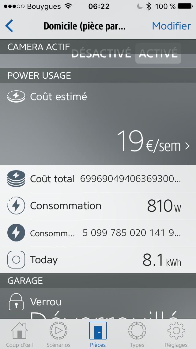

fennec62
Posts: 43
Joined: Sunday 26 October 2014 22:11
Location: france
Re: homebridge-edomoticz Plugin
Post by fennec62 »
hi
i use mqtt branch
and power energy view in switch
         "AddjMulti" : 1.0,
         "AddjMulti2" : 1.0,

But in EVE EDF2 is switch on/off
Is it normal ?
Thanks a lot for your job

Just needs an exemption dropping in for that type & subtype combination... will get it added shortly.
As you're the first with that particular sensor and combination of values I may need to figure out how to parse it before it'll show correctly via HomeKit. Might see readings in the wrong place basically.
Extended Domoticz homebridge-plugin for latest Homebridge - adds temp/humidity/pressure sensors, power consumption sensors, DarkSkies virtual weather station support, YouLess Meter support, general % usage support & switch/lamp status checking!

If you head into your homebridge-edomoticz folder and run...
sudo git pull origin
...I’ve just added the necessary exemptions so it should now show up as a meter device.

thanks a lot
i install and i test when i come back in my home
just see the log for the moment and it's change
[eDomoticz] MQTT Message received for EDF2.
Device: P1 Smart Meter,Energy
Is Switch: false
SwitchTypeVal: false
MQTT Message:
"Battery": 255,
"RSSI": 12,
"dtype": "P1 Smart Meter",
"id": "82496",
"idx": 497,
"name": "EDF2",
"nvalue": 0,
"stype": "Energy",
"svalue1": "50996812",
"svalue2": "52119655",
"svalue3": "0",
"svalue4": "0",
"svalue5": "690",
"svalue6": "0",
"unit": 1
So when i come back i feedback
And i don't have apple TV so can't control outside but i have VPN with openswan, do yo have a idea how can i do for control homekit over VPN
Same ip but nothing, perhaps Broadcast ??
Thanks a lot

It s ok just litle bug with parse
