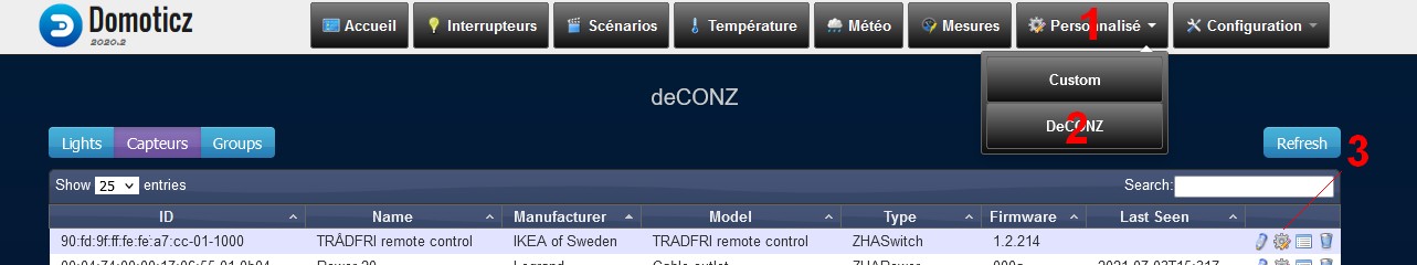

For information have just repaired the frontend, it s now possible again to configure sensors using Domoticz
Remember this tab can be disabled by defaut on domoticz.

My plugin is up to date, I have added a sensor on Phoscon app, I can see the sensor on Domoticz' deCONZ custom panel, but how do I populate Domoticz devices with this new sensor so that I can use it?
Patrice
I'm running Domoticz last stable version 2021.1
