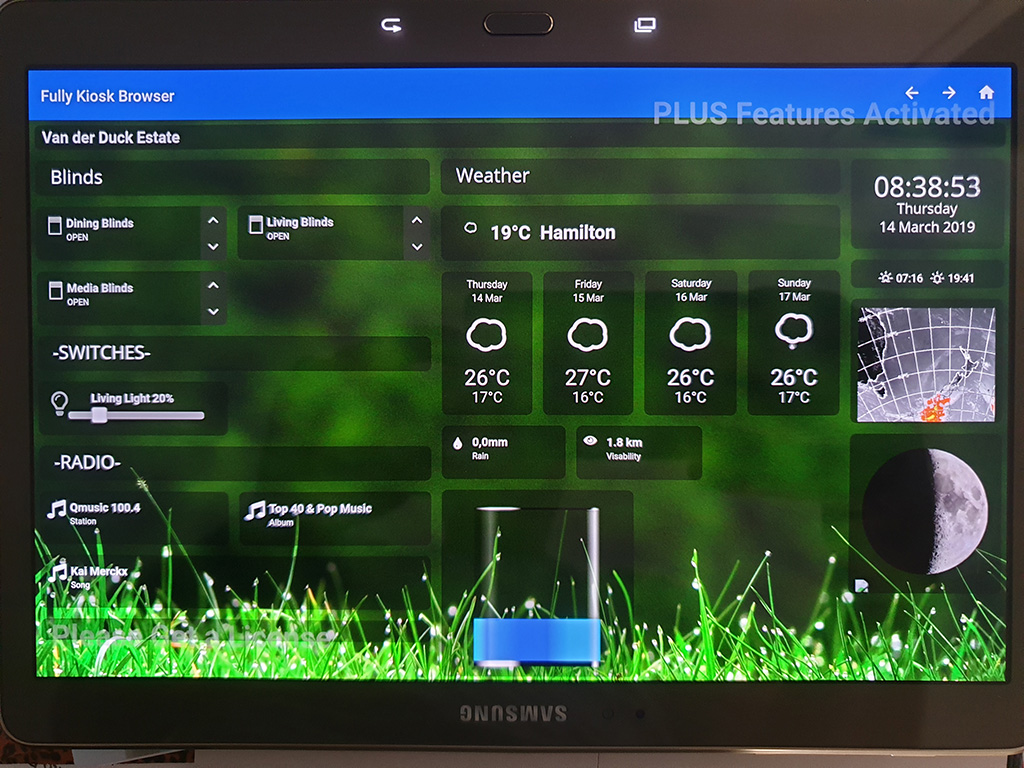

Thanks for creating the fantastic Dashticz app! I have been running Domoticz both at my home and my mountain cabin for years, but have never - until now, really got the WAF in place ;)
The control center for my mountain cabin is now finally done, with no less then 15 pages/slides and close to 150 devices. Also a bunch of css styling and some changes to source code (committed to github, https://github.com/Dashticz/dashticz_v2/pull/436).
I'm using a Huawei MediaPad T5 10 inch Android tablet, running Fully Kiosk Browser (https://play.google.com/store/apps/deta ... erov.fully) in kiosk mode for rendering the dashticz site, Fotoo app (https://play.google.com/store/apps/deta ... m.bo.fotoo) for photo screensaver and tasker to report tablet battery status to Domoticz. The battery status is used to switch on or off the charger, using a wall plug, keeping the battery level between 30% and 80%.

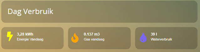

pkessels wrote: Sunday 17 February 2019 12:37 watermeter.jpg
I'm working on my dashboard, but when I add the water meter I don't see the used liters today values but an ? with a total value and not the daily.
Any ideas how to solve this?
Hello PKessels, do not know of you solved your problem yet.
I used part of the info of the sensors 'blocktitle_8','92_2','94_1','152_1' where 92 is my electra 94 is my gas 152 is my water usage this day
Hope this helps
Jack
dagverbruik licht gas water.PNG (38.24 KiB) Viewed 6979 times
