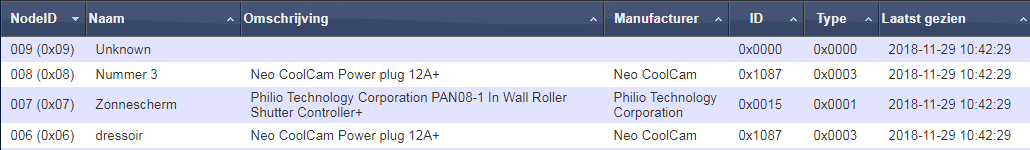

Re: Cheap chinese z-wave products
@LouiS22, it's been a while that you've posted about the HS1SA smoke sensor. I was woundering. Did you get it to work with Domoticz? I've got exactly the same, but I can't get it to show up in my hardware list (see image 0x09). Do you have any tips on what i can try to make it work?LouiS22 wrote: Saturday 01 July 2017 8:10 Just a quick feedback.
Arrived yesterday: https://www.aliexpress.com/item/Z-wave- ... 0.0.QIDx6w
As I initially suspected, this is Heiman's smoke sensor - and it really is, detected as Smart Sensor HS1SA. The package is a pain white box with only chinese manual included, but you can find a detailed english version at z-wave alliance database. There's not much to configure, only wake-up timeThe inclusion a bit tricky: there's a small hole on the side of the device, you have to put a thin nail or something similar to it, an push it three times. Did a test, it's a noisy beep-beep-beep
I'm using domoticz on my Synology NAS and have Aeotec ZW090 Z-Stick Gen5 EU (see image)
Neo CoolCam Power plug 12A+
Philio Technology Corporation PAN08-1 In Wall Roller Shutter Controller+
Does anyone have experience with thishttps://nl.aliexpress.com/item/Z-wave-S ... 0.0.QIDx6w Z-wave smoke detector using Domoticz on a Synology NAS?
I've been trying to get it to work, but haven't been succesful.
I hope there are people who can give me some pointers.

Yes, it's working, I think your network didn't recognize it properly (unknown). Try to exclude that unknown node (If I recall it, there's a small hole on the side of the sensor and you have to push it 5 times (not sure, please check the manual) to trigger the exclusion.gerthjan wrote: Thursday 29 November 2018 10:47@LouiS22, it's been a while that you've posted about the HS1SA smoke sensor. I was woundering. Did you get it to work with Domoticz? I've got exactly the same, but I can't get it to show up in my hardware list (see image 0x09). Do you have any tips on what i can try to make it work?LouiS22 wrote: Saturday 01 July 2017 8:10 Just a quick feedback.
I'm using domoticz on my Synology NAS and have Aeotec ZW090 Z-Stick Gen5 EU (see image)2018-11-29 10_44_50-Domoticz.png
