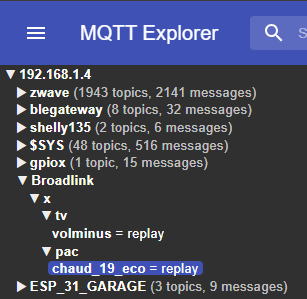

I gave up this plugin and now I use this
https://github.com/eschava/broadlink-mqtt
Now I can control (Heat Pump / Tv / Soundbar / candles(LED) like this
from Dzvents script with executeShellCommand:
In Mqtt explorer:

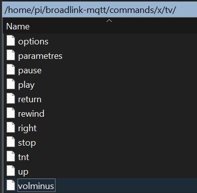

In fact the topic above correspond to the folder/file where the IR command is stored
The best : I copy the old IR commands from the python broadlink plugin (the .ini files) into the folder of the broadlink-mqtt (I renamed them and keep in, only the IR code) and it's working WELL!
There is also an automatic learning functionality of new IR code but I did not use it yet
I hope that would help someone...
