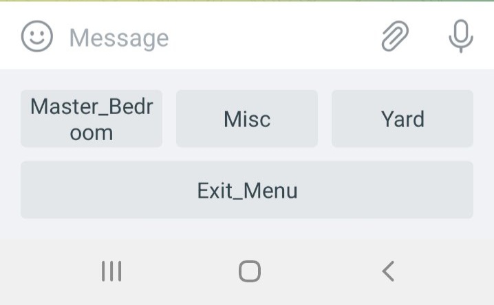

mojso
- Posts: 95
- Joined: Friday 08 November 2019 23:07
Re: dtgbot - Domoticz TeleGram BOT
Very good my friend, It works great
jvdz wrote: Saturday 13 August 2022 10:44 Just pushed the changes to GITHUB branch Stability-and-new-install:To Use MenuWhiteListing use the below:Added Whitelist for menus per TelegramID
Fix for Devices <name> st
Added SYSTEMD service compatibility
Several Bash commands fixedjvdz wrote: Friday 12 August 2022 16:51 add this Domoticz TelegramRoomsShownInMenu Variable:The way it currently works is that it will go down this decision path and the first line that is true will be used:Code: Select all
0=2,3,5,9,10|1111111=2,3,10|2222222=3,5
- When The SendTo ID is found in the table the Rooms listed behind the = sign are shown for the ID.
- When 0 (Considered Default for All) is found in the table the Rooms listed behind the = sign are shown. (2,3,5,9,10)
- Else it will show all Rooms
- First user
- IMG-1015e890cba5eb1ec5a1ef7c39d1f5c4-V.jpg (27.53 KiB) Viewed 5846 times
- second user
- Screenshot_20220813-164956_Telegram.jpg (93.12 KiB) Viewed 5846 times
- jvdz
- Posts: 2485
- Domoticz version: 4.107
Great to hear it works for you!
