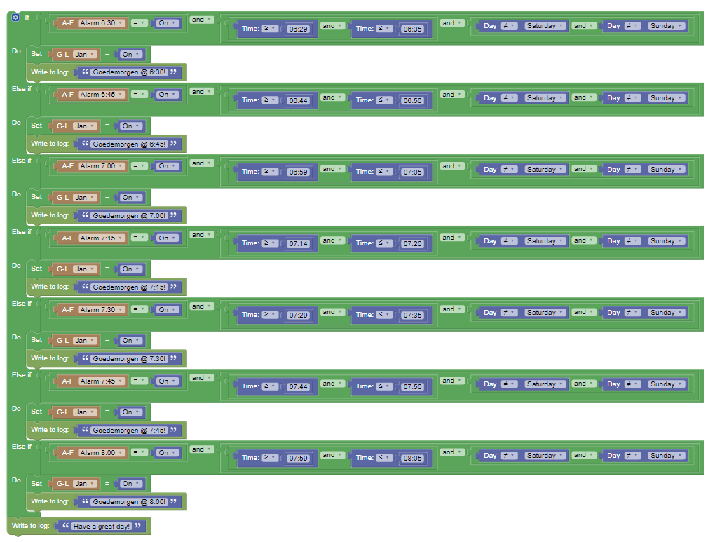

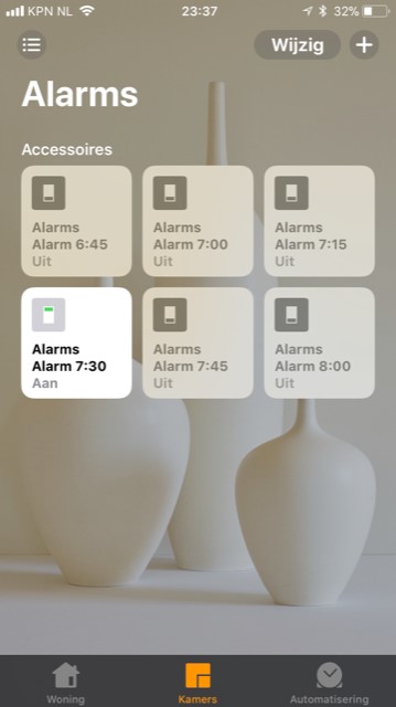

I've created this blockly to act as an alarm clock / wake up light. It's not a dimmer so it just switches on at a certain time.
I haven't found a way yet to read the time set in the iOS alarm and use that, so I have to set my alarm twice at night. However when I have to wake up multiple days in a row at the same time, there's no issue. I have to set the 'light alarm' separately as a virtual switch now.
I've added al these manual switches to a separate 'Alarm' room in the Home app.
Any suggestions om how to make this better / easier?

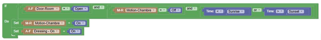

I made two events to turns on the light when a door is opened and turns off if no motion.
The first event turns on the light and the motion (type Blocky, DEVICE)
The second event turns off the light if no motion (type Blocky, ALL)
The problem is when the door stays open, the light does not turn off :-(
I thought that a blocky device event only changed when a state change occurred.
Here, many times the door stays open and unfortunately also the lights.

CLEMENT99 wrote: Monday 26 March 2018 12:58 I made two events to turns on the light when a door is opened and turns off if no motion.
Well, the problem seems to be that the second blocky with the "xiaomi human sensor"=OFF does not work.
I tried with "xiaomi human sensor" NOT EQUAL motion but it's also not working.

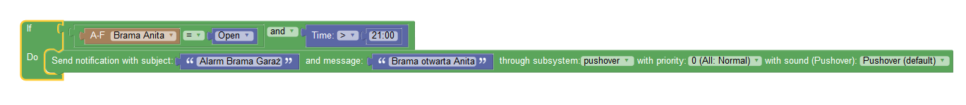

Hello
Recently, I've been interested in domoticz, but there is a problem that I can not deal with. I count on the help of forum users. I built a script that verifies the garage door. If after 21:00 the system checks that it is open, it sends a pushover notification. Everything is ok but notifications are given every minute. Is it possible to set that open gate notifications appear every 15 minutes or every 30 minutes.

Post by tozzke »
that is possible using blockly by adding a variable so that you'll get something like:
If [Brama Anita] = [Open] and [Time > [21:00]] and [variable] = [0]
Do [Set [variable] = [1]]
[Send notification...]
[Set [variable] = [0] After [900] seconds]

@tozzke
thank you very much for your help, in fact after adding the variables everything works perfectly.
