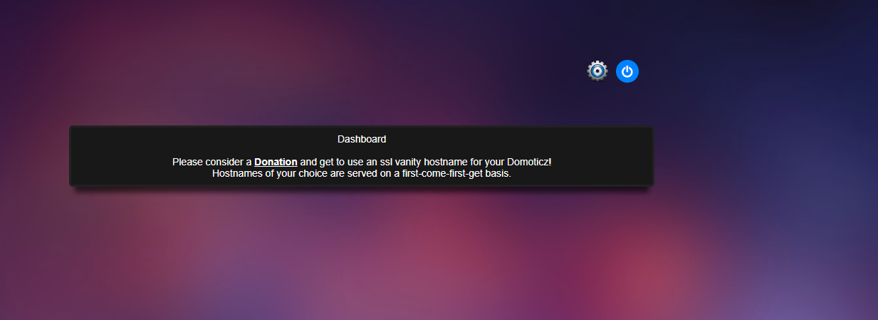

Oh one more "bug"
Just changed the name of my domoticz on my.domoticz.com proxy and after that just blank dashboard.
my domo.png (139.43 KiB) Viewed 3623 times
chimit
Posts: 259
Joined: Saturday 18 April 2015 18:55
Domoticz version: master
Location: Rotterdam, the Netherlands
Re: MyDomoticz - Testers wanted!
Post by chimit »
jaha wrote: Friday 06 April 2018 10:34 Oh one more "bug"
Can you try again?
jaha
Posts: 55
Joined: Thursday 26 January 2017 10:26
Post by jaha »
chimit wrote: Friday 06 April 2018 10:40
Can you try again?
Same thing, just restarted but still blank.
Log looks good.

jaha
Posts: 55
Post by jaha »
Can you try again?
Plz fix :)
chimit
Posts: 259
Post by chimit »
jaha wrote: Monday 09 April 2018 22:29 Plz fix :)
Could you PM me your api key or instance id?
I have exact same problem.
If i go directly http://my.domoticz.com/my/MyDomoticz Instance ID - it works but dashboard is empty.
chimit
Posts: 259
Post by chimit »
One reason can be that you have two Domoticz instances.
It's possible that they have an identical apikey, when a backup from the first is transferred to the second at some point.
Another reason can be a network hitch. When you domoticz notices a disconnect it tries to connect again.
But if meanwhile MyDomoticz didn't notice the disconnect yet, it thinks your instance tries to connect multiple times at once.
== Rene
