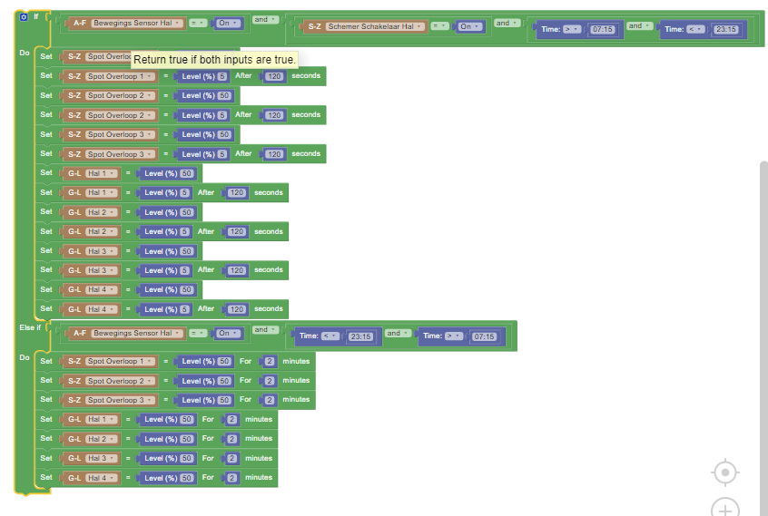

Hi Chatjozef,
Thanks for the hint, I thought of this, but it adds extra lines, 7 in total as we cannot work with groups.
It does not solve my problem. I think that blocky is not to intelligent. I have the feeling that every so many seconds the script is run.
So when my motion sensor is triggered lights will go to 50%, then when script runs again, it starts with the first line, stating to switch on lights at 10%, when conditions are met, and that is with all testing I did after approx. 35 seconds.
I will try to split the script into 2 events. One for turning on lights via Dusk Sensor and one for when motion is detected and lights will have to go up to 50% for 2 min.
In general my feeling is that the "set xxxx = yyyy for zz min" is not working as it should.
It there someone out here that has this statement working as it should?
Will LUA overcome the way scripts are handled?

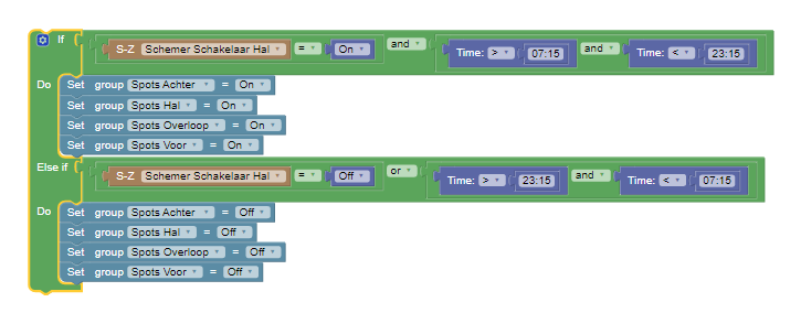

All,
Just split it up in 2 blocky scripts:
one to switch on/off via Dusk sensor: and one to trigger brighter light when motion is detected: Just checked and now light return to 10% after approx. 65 seconds, still 55 short from the 120..
I am not sure anymore Domotics can do what I want (which I believe to be very simple):
Switch light on when Dusk sensor is on and when motion is detected brighten lights to 50% for 2 min.
Help is much appreciated.
Bernard

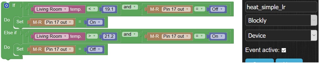

I am running the same blocky configuration for temperature control running on a fresh install of version v3.8153 on a Raspberry PI noobs.
The temperature is coming from the EQ3 Max! lua scripts. In the logs there are no event entries for the two temperature blocky events. When I set a time event it is run without a problem.

Hi Stanleyk,
try this
IF teplota1 > 10 and teplota1 < 28 and Relay 1 = off
Do Set Relay1 = on
Else if teplota1 > 29 and teplota1 < 50 and Relay 1 = on
Do Set Relay 1 = off
Or
IF teplota1 < 28 and Relay 1 = off
Do Set Relay 1 = on
Else if teplota1 > 29 and Relay 1 = on
Use the option "Else if" and not the option "if"

Hallo Cobra,
Thanks for the quick reply Does this look correct? it is also not running.

Hi Chris68,
I think 19.1 and 22.1 do not work.
First try something simple
Cobra045

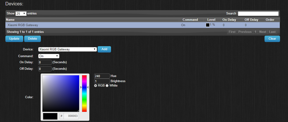

Is there a blocky way to change te color and brightness settings of my Xiaomi Gateway.
kluczus
- Posts: 24
- Joined: Tuesday 12 September 2017 14:39
Re: Blockly examples
Yes of course, just add scene and activate it by blocky.frigide wrote: Thursday 28 September 2017 23:31 Is there a blocky way to change te color and brightness settings of my Xiaomi Gateway.

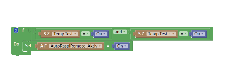

I have a little problem.
I want to switch the "AutoRaspiRemote_Aktiv"-switch on IF switch "Temp.Test" AND switch "Temp.Test.1" is set to ON.
And if switch "Temp.Test" OR switch "Temp.Test.1" is set to Off, "AutoRaspiRemote_Aktiv"-switch must set to OFF
at first i tried it like the picture below but nothing changed. I also tried it wirt uservariables but nothing happened.
What did I wrong?
I hope someone can help me
Greetings
What did I wrong?
Greetings
- sw.PNG (11.79 KiB) Viewed 16202 times

If you use only one If statement, you'll have to use the other If-block without the blue icon on the top left

I have solved my Problem with including the state of "AutoRaspiRemote_Aktiv" in the IF-Question:
IF <Switch.1 is> on AND <Switch.2> is on AND <AutoRaspiRemote_Aktiv> is on THEN SET <AutoRaspiRemote_Aktiv> off

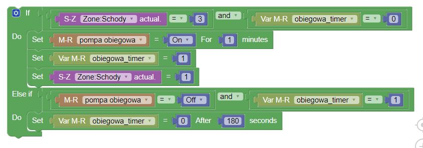

I'm trying to make Blockly to set "on" my hot water circulation pump(pompa obiegowa) for 2 minutes after PIR (zone:schody) sensor is on, then script should stop pump for next few minutes (for test it is 180sec ).My goal is to get max 1minut of working for 20 minutes.
Unfortunately after first circle system get's some kind a loop and all the time it is seting Var=0 (obiegowa_timer). Mayby someone could find mistake in my blocks?

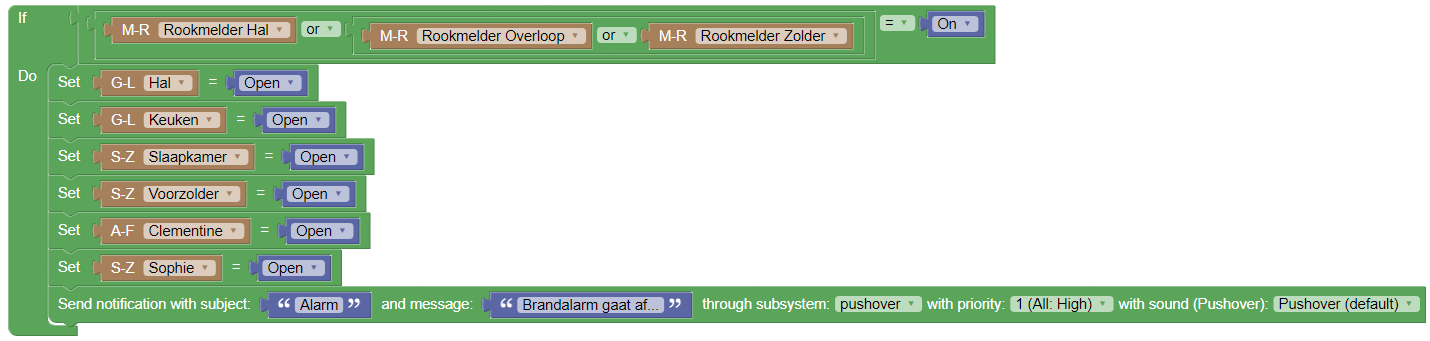

Hempie
- Posts: 11
- Joined: Wednesday 15 November 2017 17:22
- Location: Aalsmeer
After some days struggle i hope someone is pointing me into the right direction.
I got a (3)Fibaro Smoke Sensors (FGSD-002) and some Somfy RTS shutters.
In case of Fire i want my shutters open on detection.
Noting is working, even if i change ''panic'' to ''on'
What im i doing wrong here
Last edited by Hempie on Thursday 23 November 2017 22:35, edited 3 times in total.

- StanHD
- Posts: 347
- Joined: Friday 12 July 2013 16:09
- Target OS: Windows
- Location: East Sussex, UK
If Rook Alarm = Panic ?
Python:- Broadlink RM2, Sonos
Hempie
- Posts: 11
Rebuild it, this is how i tested it
*post updated
RFXTRX433E, Aeon Z-Stick Gen 5, Harmony Hub, Nefit Easy, Homebridge, Somfy RTS, Fibaro
Hempie
- Posts: 11
Firedetection & open shutters
This seems to be working.

tozzke
- Posts: 135
- Joined: Friday 02 January 2015 9:22
- Domoticz version: Stable
I don't think this will work because you have to specify the status of every smoke detector/switch, Blockly won't allow it like the way you did.Hempie wrote: Sunday 26 November 2017 8:47 Firedetection & open shutters
It should be:
If [Rookmelder Hal] = [On] or [Rookmelder Overloop] = [On] or [Rookmelder Zolder] = [On]
Do ...
Hempie
- Posts: 11
Thank you @tozzke i will test this when i'm home.
