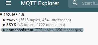

madpatrick wrote: Sunday 07 December 2025 17:51 Must i clear all retained messages ?
I'm surprised you ask this question. Try to understand how things work first so you can make that decision yourself! ;-)
zwave2mqtt sends a discovery message for each device at startup and when it gets a message that (in this case) HomeAssistant is up.
So when these messages are retained, they stay there forever until somebody removes them. So when you remove any devices in ZWAVE2MQTT for being advertised, you need to remove their discovery record from Mosquitto too when you defined to retain these messages.
Now it is up to you to see what information is contained in the homeassistant message tree and what can be deleted.
Deleting all for zwave2mqtt (subtree under homeassistant) should normally work, as it will send all messages again when domoticz or zwave2mqtt is started.

jvdz wrote: Sunday 07 December 2025 18:12
Maybe a bit more info on the Wiki. Nothing is mentioned about the MQTT explorer or some alike
Not all users a IT (like me) Some time it helps when it is in Jip & Janneke language ;)

madpatrick wrote: Tuesday 09 December 2025 12:43
https://wiki.domoticz.com/Zwave-JS-UI#Debug_MQTT
It ihas a reference to the general MQTT wiki debug section: https://wiki.domoticz.com/MQTT#Debugging_MQTT
And in the Zwave-JS-UI documentation it is also mentioned: https://zwave-js.github.io/zwave-js-ui/ ... leshooting
