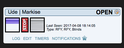

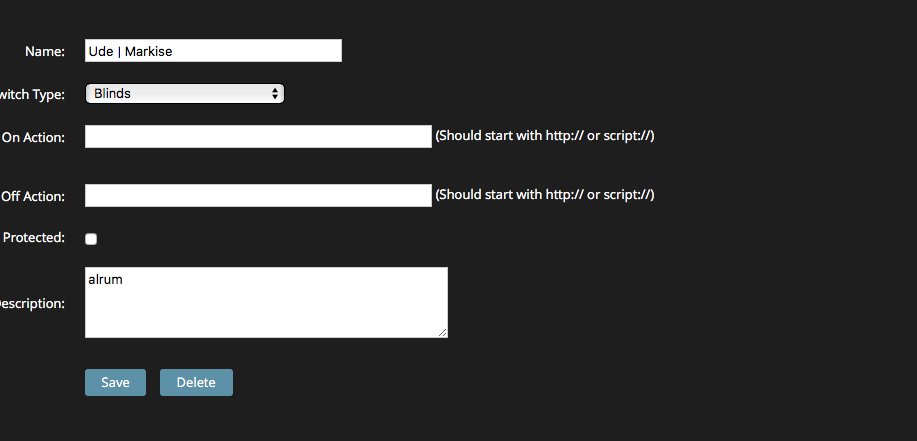

I do have regular blinds with stop, thats work
So stop is not only for venitan blinds.
In my setup this is the json for blinds without stop
and this is for blinds with stop

},Code: Select all
"AddjMulti" : 1.0,
"AddjMulti2" : 1.0,
"AddjValue" : 0.0,
"AddjValue2" : 0.0,
"BatteryLevel" : 255,
"CustomImage" : 0,
"Data" : "Open",
"Description" : "alrum",
"Favorite" : 1,
"HardwareID" : 10,
"HardwareName" : "PiTeknikskab",
"HardwareType" : "Domoticz - Remote Server",
"HardwareTypeVal" : 3,
"HaveDimmer" : false,
"HaveGroupCmd" : false,
"HaveTimeout" : false,
"ID" : "010101",
"Image" : "Light",
"IsSubDevice" : false,
"LastUpdate" : "2017-04-08 18:14:05",
"Level" : 0,
"LevelInt" : 0,
"MaxDimLevel" : 0,
"Name" : "Ude | Markise",
"Notifications" : "false",
"PlanID" : "11",
"PlanIDs" : [ 11 ],
"Protected" : false,
"ShowNotifications" : true,
"SignalLevel" : "-",
"Status" : "Open",
"StrParam1" : "",
"StrParam2" : "",
"SubType" : "RFY",
"SwitchType" : "Blinds",
"SwitchTypeVal" : 3,
"Timers" : "false",
"Type" : "RFY",
"TypeImg" : "blinds",
"Unit" : 1,
"Used" : 1,
"UsedByCamera" : false,
"XOffset" : "0",
"YOffset" : "0",
"idx" : "124"

Ok, stop button is back... does anyone know when the stop button work and when it doesn't?
Edit: Thanks for the output, but is that always the case? Could someone else confirm?

My output where i have no stop button is actually a fibaro shutter 2, there the stop button dosent work, even if i set it as a venetian.htilburgs wrote:Ok, maybe I'm mistaken.
I've a Fibaro Shutter 2, but the STOP function is not visible, until I set it as Venetian Blinds.
But in that case, the STOP function doesn't work.
But if you have a Fibaro also and have it working, than I love to hear about it.
We will have to move to an other section in this forum.
My subtype RTY where the stop is working is somfy blinds
