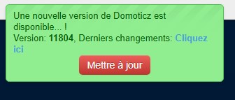

Posted: Monday 23 March 2020 10:13
by monfiston
Hello
since yesterday, I have this message which appears in domoticz
I clicked on the link to update it, but the update looks like it won't start

Re: How to install Domoticz on a Synology NAS
Posted: Monday 23 March 2020 10:41
by waaren
monfiston wrote: Monday 23 March 2020 10:13 since yesterday, I have this message which appears in domoticz. I clicked on the link to update it, but the update looks like it won't start
This button has no function with domoticz on a Synology NAS. You will have to wait until @jumbotroll prepared a package (if at all possible for the ds115j)
You can get rid of the message by unmarking
Software Updates:
Check for Updates (Not working on windows systems)
in tab
[setup][settings][system]
Posted: Monday 23 March 2020 10:42
by dressie
monfiston wrote: Monday 23 March 2020 10:13 Hello
domotics is installed on my nas synology ds115j
do you have a solution?
You can't update within Domoticz on a Synology. You will have to download the new version from http://www.jadahl.com/
Posted: Monday 23 March 2020 10:52
by monfiston
thank
