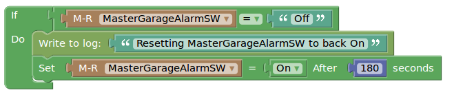

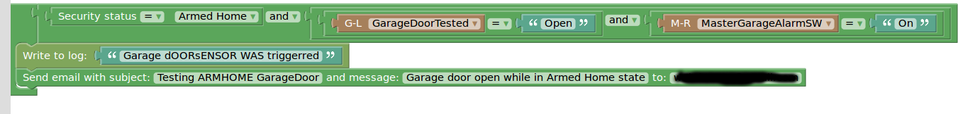

I sort of resolved it by adding a virtual Switch and use that instead of the security panel for widget and switch screen. I set the switch to turn back off if its turned off after 3 mins.abductor wrote:Did you get your issue(s) resolved? I have the same problems. Don't like waiting for loading screen when I come home and want to disarm the alarms. Thanks!sundberg84 wrote:Hi!

I also AND all my security statements with that virtual switch, so when I turn that switch off, it turns off my alarms. This is great for when I come home and want to enter from the garage, it'll turn off the alarm for 3 mins, enough time to get inside and I dont have to waste time to input the code.
The virtual switch is called MasterGarageAlarmSW in my example. I have a door sensor called GarageDoorTested.
- Security system for garage door

- Example of a switch that turns back on after 3 mins.
