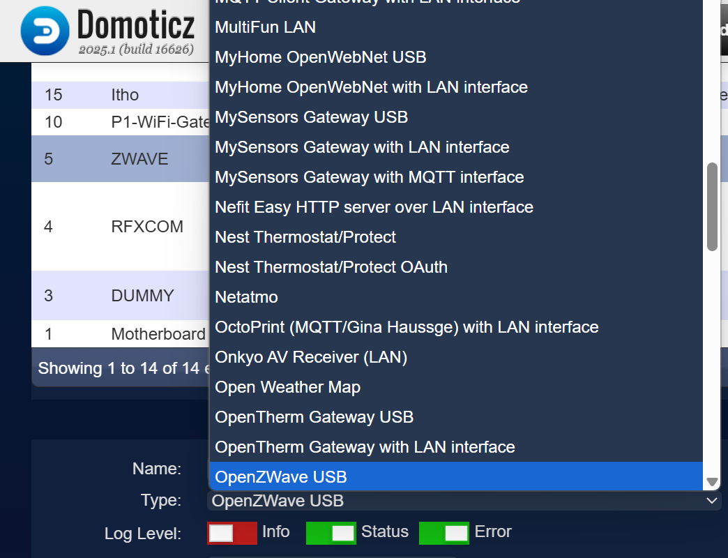

Are you sure that OpenZwave isn't supported any more, or is this an assumption? I am currently running 2024.7 with OpenZwave support just fine. OpenZwave was put back in since so many are still using it. I haven't tested the latest Beta in my production environment, but loaded the latest Beta in a test Docker environment and see that Hardware OpenZwave is still there:
Schermafbeelding 2025-04-13 155703.png (166.44 KiB) Viewed 5897 times

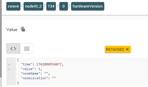

They way took the approach is as following.
I temporally disabled zwavejaui and broker.
Then i deleted all unwanted zwave devices in Domoticz and shutdown Domoticz afterwards.
Then i restarted zwavejsui and broker while Domoticz is still killed.
Then i disabled all unwanted devices in the "Home Assistant" tab for every node.
After that i deleted all retained messages in the broker with mqtt explorer.

Siewert308SW wrote: Sunday 23 November 2025 21:53
I'm a bit new to MQTT so i like to be sure.
Do you mean with deleting the retained messages these messages ?
2025-11-24 19_18_40-MQTT Explorer.png (9.07 KiB) Viewed 3840 times
Just push the yellow " retained" button ?

madpatrick wrote: Sunday 07 December 2025 16:45 Where is it going wrong for me ?
Did you remove the old retained mqtt messages from mosquito?
madpatrick
Posts: 895
Domoticz version: 2026.1
Re: Easiest way to migrate Openzwave to ZWave-JS-UI
Post by madpatrick »
No.
Must i clear all retained messages ?
