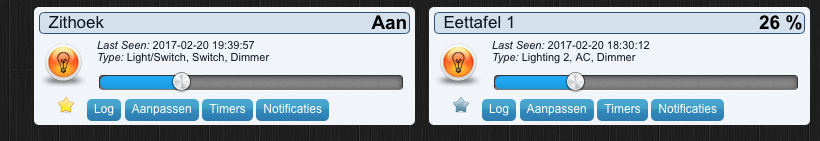

I really love the domoboard! Been playing with it for a while now. Everything works fine, but there is one thing that I can't fix. I have three dimmers (two Hue lamps and a Fibaro dimmer 2). In domoticz they are shown as dimmers with a slider.
When I add them to the domoboard the Hue lamps (IDX 16/17) do work, but the Fibaro dimmer (IDX 1) doesn't. I get an empty square. When I add the dimmer as switch it does work (only on/off, no dimming).
I saw in the devices table of domoticz that the subtype of the Hue lamps is AC and light/switch for the Fibaro dimmer. I thought that that could be an issue. So I added a dummy switch and set the type to dimmer (IDX 29). Then I've added the dummy dimmer to domoboard and guess what: a slider![]()
Does anyone have an idea of how I can get the Fibaro dimmer in domoboard?
Hmm that's an unusual behaviour. did you get an error in you're console.log when domoboard tries to init an dimmer on zithoek?
It looks like it should work but if there are no errors its a little bit difficult to debug it

strange do you still get an error because we have never seen this error before.miljume wrote:Hi guys,

Well, I did some testing with a conf-file with only one dimmer. Unfortunately, without results. When I add the Fibaro dimmer I still get an empty square. When I add a different dimmer, everything works. I also tried do reinstall domoboard, also without results... I can't figure out what causes the empty square. Also...it is indeed difficult to debug when there is no error

damn that's strange. And with an dummy type with the same as the fibaro you did get an slider right?ztorm wrote:ztorm wrote:Thanks for your reply. I couldn't find an error in the console.log. I will create a simple conf-file with only the Fibaro dimmer and will try again. Maybe I get an error in the console.log. I'll post my resultssquandor wrote:

Yeah strange. Yes, with a dummy I get a slider.

What you could do is retrieve the json manually from domoticz http://<ip-domoticz>/json.htm?type=devices&rid=<idx>ztorm wrote:Yeah strange. Yes, with a dummy I get a slider.
with the idx of you're fibaro dimmer and return the result to here. Maybe the value of the dimmer has been in an different key which could result in breaking the init of the dimmer.

Here is the json of the Fibaro dimmer:squandor wrote:What you could do is retrieve the json manually from domoticz http://<ip-domoticz>/json.htm?type=devices&rid=<idx>ztorm wrote:Yeah strange. Yes, with a dummy I get a slider.
"ActTime" : 1487616008,
"ServerTime" : "2017-02-20 19:40:08",

The problem is that "Data" and "Status" only show the status "On". The others dimmers show the level of dimming in those fields. This is also the case in Domoticz on the page with the switches.
The status of Zithoek is just ON and the status of Eettafel shows the percentage of dimming.
I don't have a clue how this can be fixed... or maybe it can't...
