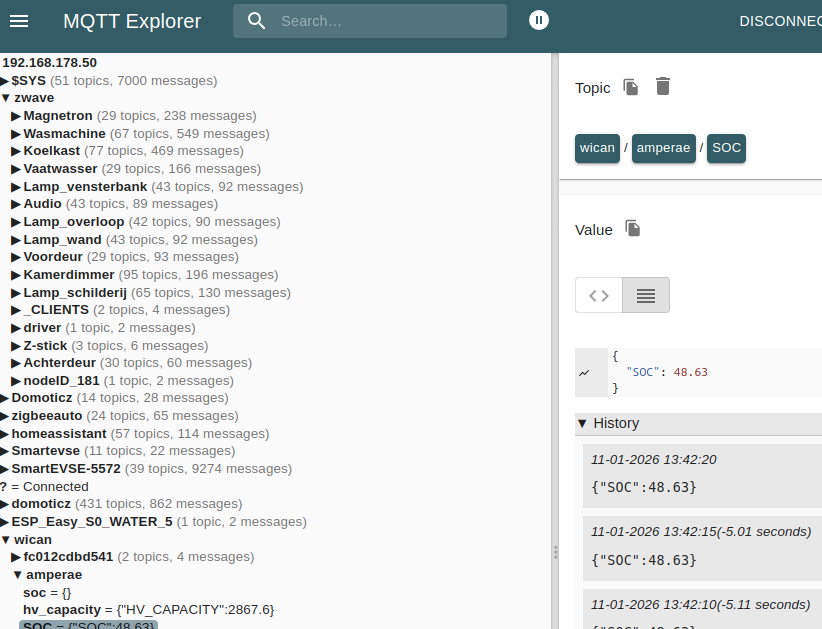

Is it possible to get a copy of what Mqtt Explorer shows when you receive a change in the considered topic?

NvBgm wrote: Thursday 08 January 2026 9:47 I'll try it.
In the Domoticz log, I see the following:
2026-01-08 07:23:51.107 Error: (ProcessInbound) MQTT protocol violation: Invalid message length 59 for packet type '3' (iQoS:0, topicLen:13568)
2026-01-08 07:23:51.107 Error: (ProcessInbound) MQTT protocol violation, sending DisconnectedEvent to Connection.
It seems that the MQTT packet received by Domoticz is an illegal one (topic length seems corrupted). MQTT connection is deleted by Domoticz before MqttMapper receives the packet (thus, not doing any changes into device).
It could be interesting to install MqttExplorer (from https://mqtt-explorer.com/) to try getting sent frame.
What's kind of device is sending these frames?

FlyingDomotic
Posts: 463
Re: Python Plugin: MqttMapper
Post by FlyingDomotic »
Ok, I got the frame. I now need to analyze it.
Stay tuned!

I made a new topic in the mapper config file the SOC for my car but the error in the domoticz log is"Error: Mapper: Can't find device key wican/amperae/SOC"
The wican module of my car gives in the mqtt explorer wican/amperae/SOC. I am on Version: 2025.2 (build 16836)
And the json file is
    "amperae State of Charge": {
        "topic": "wican/amperae/SOC",
        "type": "243", "subtype": "6", "switchtype": "0",
        "mapping": {"item": "", "multiplier": 0.1}
    /code]
