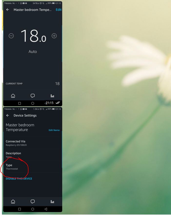

Little progress
The temperature sensor is now recognized as thermostat. Alexa responsed with ....does not support that when ask about the temperature

It's almost working perfectly for me now. Can see both temps and setpoint of my sensor and thermostat via the app. Can query the current temp and setpoint perfectly via voice. Only small thing is when I ask to change setpoint or change via the app it comes up with an error but it works regardless....so not a major.

Hi Chakkie - yep, sorry, sensors are a pain for me, I don't have any, so coding blind

Just tried and the temperature is working fine on my system now, the fix you've applied today has certainly worked for me.
