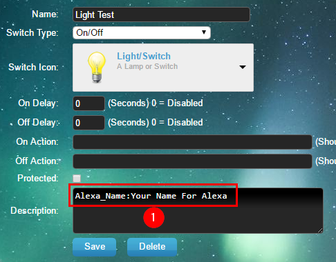

In some cases you want another name in alexa then the device name in domoticz.
Because alexa does not unterstand the name or the name is too long to speak.
Now it's possible (with the new version of domapi.js) to set the device name for alexa in the description field of each domoticz device.
Write in the description field: Alexa_Name:Your Name For Alexa
See attachment (1).
So the device name "Light Test" is ignored and "Your Name For Alexa" is the new device name.
You can write additional informations in the description field. No problem. But not in the same line!
@madgeni: In the next days, i will add these informations to the manual.

All you need to do is:markk wrote:Hi. I followed the original instructions weeks ago and was so pleased to get this working. The update to allow renaming of devices is drawing me in but I don't want to start the whole process again in case I break anything. Is someone able to tell me what are the bits I need to amend please?
In Domoticz - under switches
in the Description - put: Alexa_Name:Your Name For Alexa - where Your Name For Alexa is the name you want.
Then Forget and Discover in Alexa app.
This is after you've downloaded, zipped and uploaded the code from github (making sure to update the conf.json to your own settings).
To be sure, download your code from your lambda first, so you can revert back to it with no problem
