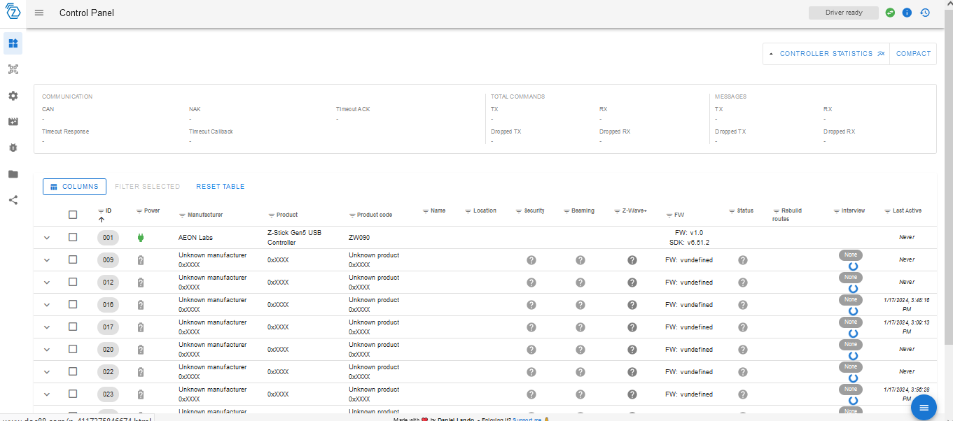

Hi Guys,
I just made my attempt to migrate to ZWave-js-ui and i have failed. The problem i was getting is all devices were showing as "unknown" except the Zwave stick. Some of the devices started eventually changing status light to "green/available" but still details were unknown about them. The device index numbers have been preserved as there were in Domoticz. When i enabled debug i was also able to see messages transmitted across my Zwave network.
Any suggestion what did i do wrong? Zwave js ui view is attached. I installed it in the docker.
thanks.
thanks.

Re: Easiest way to migrate Openzwave to ZWave-JS-UI
In case of battery operated devices this may take some time.
You can try to wake them up by briefly removing the battery and reinserting it, then click on Re-Interview Node in the 'advanced' menu of that node.
I had to do this for a few devices, others cam up after half a day or so, depending on the set 'wake up interval' on the device.
Some are more bitchy than others....
