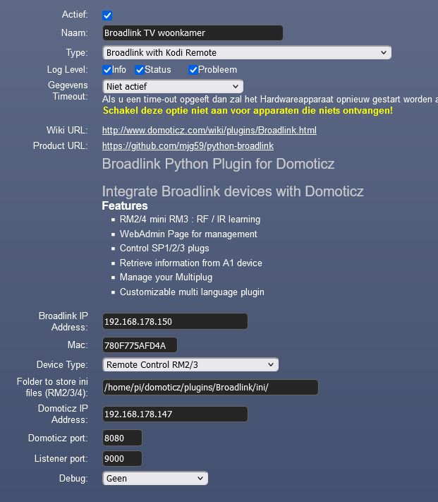

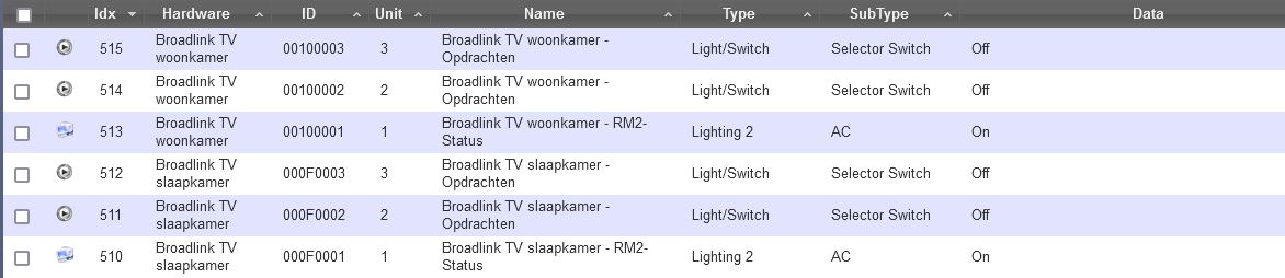

Zak45,
I still have the problem that after reboot of my Raspberry Pi running Domoticz randomly only one of my two Broadlink devices is started correctly and works correctly.
The other device does not initialize properly and shows Red in the Switches tab.
I have two Broadlink devices, one for my tv in the livingroom and one for my tv in the bedroom.
I have to define the Broadlink hardware twice in the Hardware tab, once for each of the two Broadlink devices.
For other plugins like RFXCOM I have the define the plugin only once under hardware and can add multiple devices in the Switches tab.
I particular the following error message strikes me:
2022-02-06 09:14:05.441 Error: Broadlink TV slaapkamer: (Broadlink) failed to load 'plugin.py', Python Path used was '/home/pi/domoticz/plugins/Broadlink/:/usr/lib/python37.zip:/usr/lib/python3.7:/usr/lib/python3.7/lib-dynload:/usr/local/lib/python3.7/dist-packages:/usr/lib/python3/dist-packages:/usr/lib/python3.7/dist-packages
Could it be that Domoticz only allows defining the plugin once and 'plugin.py' is locked?
See attached pictures.

zak45
Posts: 954
Domoticz version: V2024.4
Re: Python Plugin : Broadlink
Post by zak45 »
this plugin act , more or less, as the FRXCOM one....
You need to have one version by physical hardware, the same I think for RFXCOM :
How you would declare two differents RFXCOM HW ?
Let me take a look at your different settings / configuration:
provide plugin settings for both devices and folder contents.
What could help also is to put both on debug mode and provide the log files just after restarted plugins.

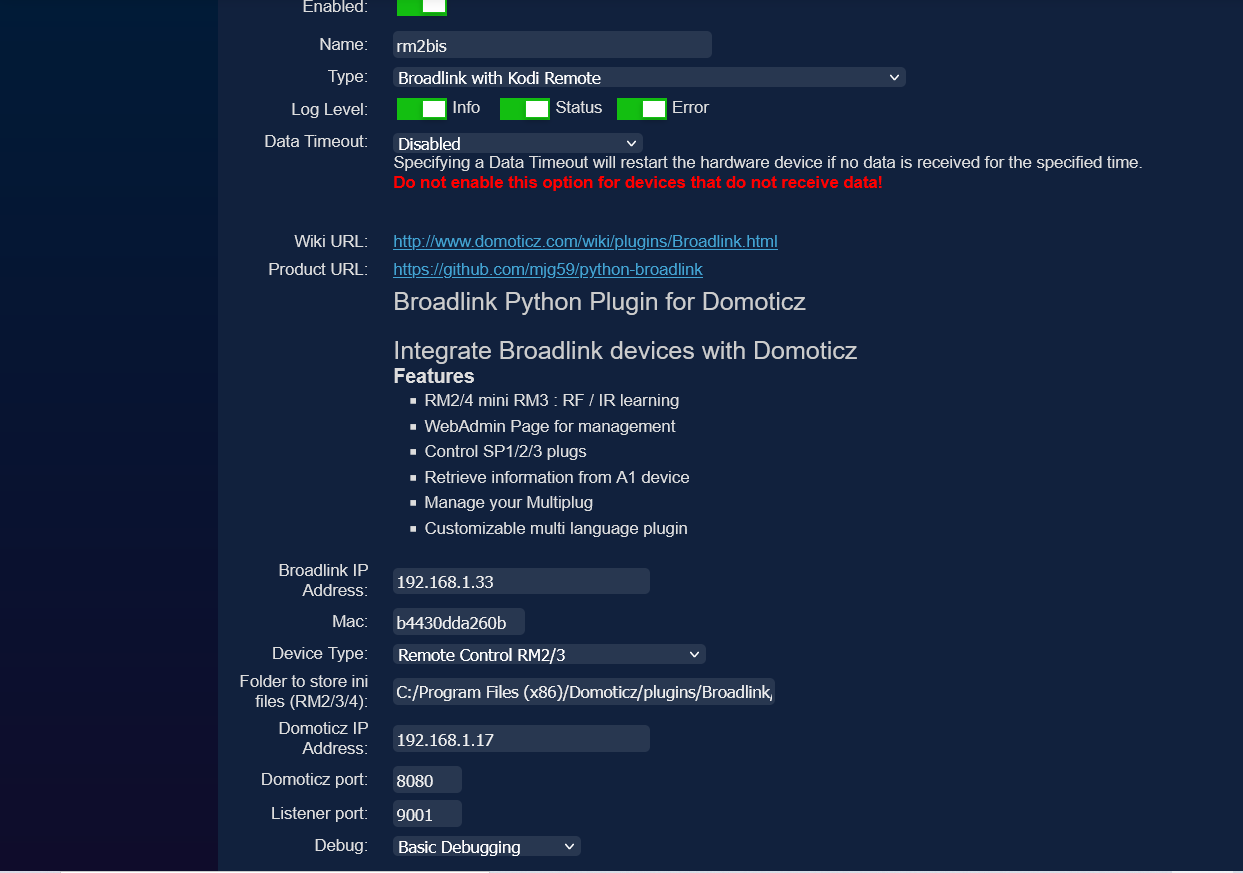

zak45
Posts: 954

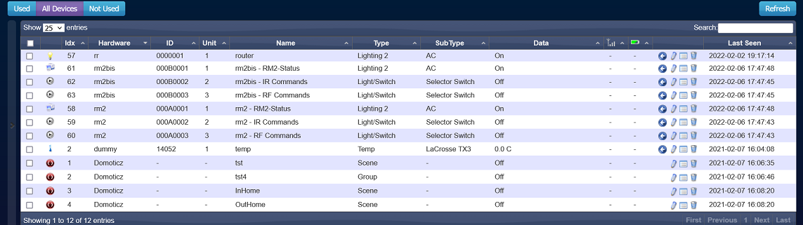

Post by zak45 »
Following config do not make sense, for test only:
I do not own two RM devices so I have declared same Broadlink device twice, and do not see any problem for the moment!

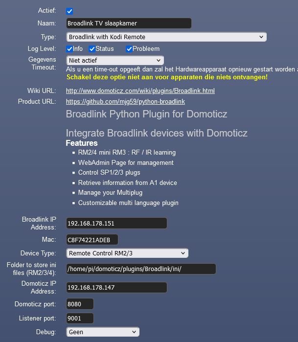

kollemt
Posts: 29
Joined: Monday 18 February 2019 20:41
Domoticz version: 2020.1
Post by kollemt »

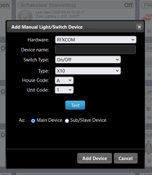

You see in the second picture of my previous reply the plugin of RFXCOM defined only ONCE under Hardware tab as I have only one RFXCOM but multiple RFXCOM devices connected to that one and only RFXCOM hardware/
In the first picture of my previous reply you see the way how I can define multiple RFXCOM switches using the RFXCOM hardware plugin.
As I have two Broadlink devices with different IP addresses I am forced to define the the Broadlink plugin twice in the hardware tab, as I have to fill in the IP address in the Hardware tab and not in the switches tab.
See attached the settings for both broadlink devices and the content of the plugin folders.
Where can I find the debug log file ?
broadlink plugin.JPG (23.01 KiB) Viewed 3033 times
broadlink woonkamer.JPG (68.92 KiB) Viewed 3033 times
broadlink slaapkamer.JPG (68.81 KiB) Viewed 3033 times
zak45
Posts: 954
Post by zak45 »
So looks like there is misunderstanding about "hardware" meaning and how this plugin work... but doesn't matter.. not the subject here !
To provide debug information, put plugin settings :
after go to plugin Web admin page, click on plugin log and copy paste the information :
e.g.:

In the debug log I only see ERROR Domoticz Log

kollemt
Posts: 29
Post by kollemt »

Zak45,
I understand you do not have a second Broadlink unit but
would it be possible for you to define in Domoticz a second Broadlink unit with a different ip address.
After the reboot I get for this not connected unit the same error message : (Broadlink) failed to load 'plugin.py', Python Path used was '/home/pi/domoticz/plugins/Broadlink/:/usr/lib/python37.zip:/usr/lib/python3.7:/usr/lib/python3.7/lib-dynload:/usr/local/lib/python3.7/dist-packages:/usr/lib/python3/dist-packages:/usr/lib/python3.7/dist-packages'.

zak45
Posts: 954
Post by zak45 »
Ok, done.
I got the expected error, as not able to connect to the device:
