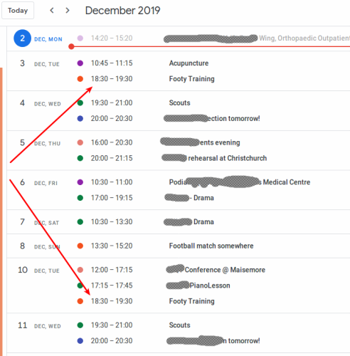

On my Dashticz installation on a Pi, I have 2 Google calendars that I want to display. Once displays fine and the other just says "Loading..."
When I look in the debug screen in Firefox and Chrome it says "200" in green for the successful calendar and "500" in pink for the one that fails to load.
I have tried installing on another Pi with the same result. One is running 3.1.2 master and the other 3.1.2 beta. I am pretty sure that both calendars worked in earlier versions.
I used the instructions at https://dashticz.readthedocs.io/en/mast ... stall.html to install.
I've just tried adding the URL for a third Google calendar and that one displays fine as well so no idea why the one calendar is failing. I've even regenerated the secret ical address for my troublesome Google calendar but to no avail.
I attach a screenshot of the issue with all 3 calendars showing or attempting to display.
Any ideas please?
Thanks.
Oh, and thanks for the formatting alignment - looks much better now.

tarmacalastair wrote: Wednesday 30 October 2019 15:53 Hi,
Any ideas please?
Thanks.
I think an error is reported by the PHP calendar module. Can you check the PHP error log?

It means the php script is running for more than 30 seconds, which is VERY long.
Do you have a lot of recurring appointments in this agenda?

Right, just done a further test....
I exported all the events from the problem calendar via the Google Calendar web page and imported it into one of my calendars that was nearly empty. Google Calendar import function reported "Imported 1104 out of 1104 events".
I then refreshed Dashticz and then had 2 calendars that showed "Loading...." and failed to load.
I have since removed all my events and added back some test events and once again the calendar started to load again.
Incidentally, I have also tried changing all my recurring events to non-recurring and all the events in the future disappear but when I download the file again using wget, it has only reduced in size by a tiny amount. I imagine that this is because all the events in the past are still in the calendar.
It would be great if we could find a solution to this but if not I might have to load my ics file in a text editor and manually remove the old stuff in order to reduce the file size.
Thanks again.

Further news to report:
On the assumption/guess that the calendar was too big to load in Dashticz, I loaded my ical file into Thunderbird (easier to scroll back than Google Calendar and easier to view than the raw text file). From here I saw that my calendar starts properly in May 2011 with regular recurring events from about July 2011.
So, on this basis, I scrolled back in Google Calendar to 2011 and started deleting events, especially recurring ones that are no longer valid. I've only got as far as September 2015 and looked back at my Dashticz screen and magically my calendar has reappeared!
I thought I'd have a look at the new file size so again I used wget from the terminal and now the new basic.ics file is 444kb. So, it's still pretty large, but at least now it is loading.
For now I will continue to see what I can remove to get the file smaller but this might be useful for other people seeing the same issue. Also, if it is possible to do anything in Dashticz to accommodate larger calendars then that would be great.
Cheers.

Probably the size itself is not such a big issue. I guess the handling of the recurring events goes wrong. It seems some recurring events will introduce an infinite loop.

I can't reproduce the problem, so testing is a bit difficult.
I made some changes to one of the php files. Could you test it?
You can download the file from here:
https://github.com/lokonli/dashticz/blo ... /index.php
Save this file in the vendor/dashticz/ical folder.

Wow, that's fantastic, it works now, thank you!
I had already modified my real calendar by taking out lots of old recurring events so in order to test your change I restored the backup copy I had made to my test calendar. I have a test Dashticz page with 3 calendars now:
  • Calendar 1 - the one that used to fail with lots of old events removed

Thanks for looking at this. Yes the alignment I was querying is as you say and it's not all that important but nice to have, if it's easy to fix.
I'm not sure if this has been reported before but I've just noticed that one of my appointment times is showing in Dashticz an hour earlier than in Google Calendar and on my Android phone.
calendar-2019-12-02 Dashticz.png (99.05 KiB) Viewed 6861 times
Google Calendar Schedule .png (72.9 KiB) Viewed 6861 times
This is a recurring event that was set up before the clocks changed at the end of October so could that be the reason. Earlier in this thread (https://www.domoticz.com/forum/viewtopi ... ng#p227426) I removed nearly all of my recurring appointments just after the clocks changed so I can't check other recurring appointments for the same problem.
I think I can probably work around this problem by deleting the recurring event and setting it up again but I thought this should be logged in case it affects lots of people.
