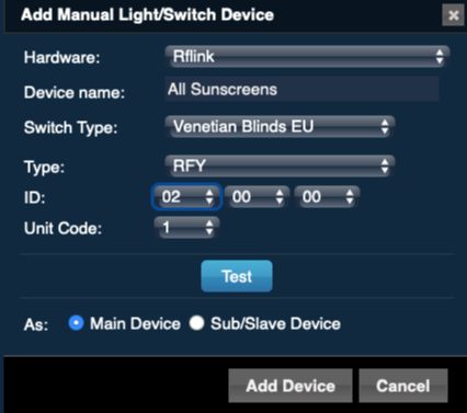

Posted: Thursday 25 April 2019 10:13
by JHO01
Had the same problem :oops: ,
Solution: when you manually add the new switch to Domoticz make sure you select unit 1. See screenshot
Screenshot 2019-04-25 at 10.14.37.png (50.06 KiB) Viewed 2461 times
When you choose unit 2, I got the reverse operation... :?
