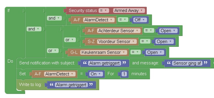

Hello heggink, Unfortunately a few weeks ago I tried to follow up on your wiki whilst not being aware of the existence of this topic and so I ran into the same problems as described here, i.e., only execution of the lua script but no subsequent triggering of the blocky events. Nevertheless, I would be very interested in testing your adapted and upgraded alarm system wiki once available.

I have a few questions regards the presented blocklies To spyseiko, is yours still set up in combination with a lua script since otherwise I may not understand what turns on your AlarmDetect switch? To maomanno,is your system now only blockly based and could your earlier comment of a less well performing fibaro smoke sensor be related to that it perhaps requires a not on but panic status descriptor?

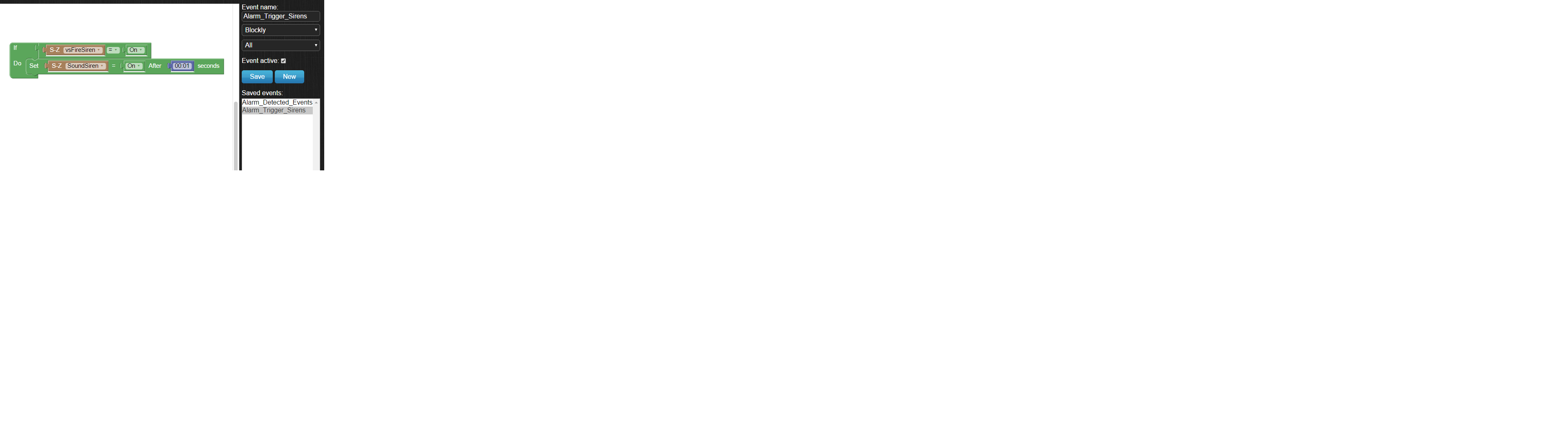

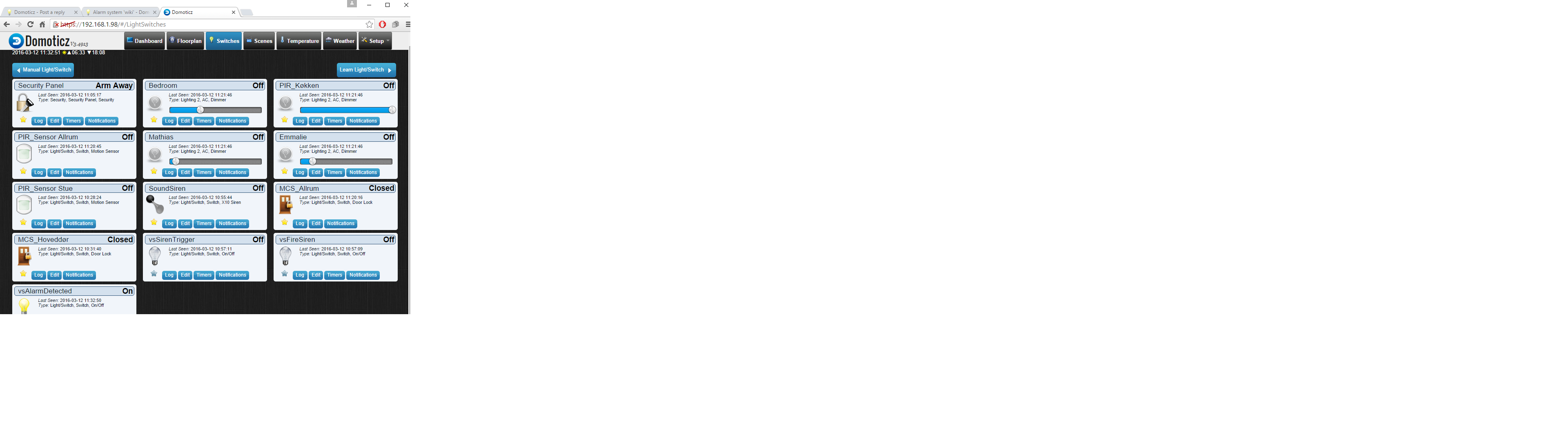

Hi peoples,
I'm new, and almost there with my setup - but I have some probloms.
I'm using the Community Alarm Script v1.0 and it does alert me on my iphone, using Pilot (Domoticz) app perfectly, also alerts me via E-mail. (All sensors working both doors sensors, and Pir sensors)
It also sets my virtuel switch on when motion or door is opened up (vsAlarmDetected)
But i cant seem to get my Events working, so it is working as wrote in the " Community Alarm Script v1.0" im, messing the grafical guidelines for the Events - i need it to work like this:
Blocky:
- Alarm_Detected_Events - This is responsible for the siren and notification
action once Lua parses the device events.
vsAlarmDetected set by Lua is the trigger
- Alarm_Trigger_Sirens - Triggered by the On status of vsSirenTrigger; resp-
onsible for the possible firing of the siren. The
time delay introduced by the previous Blocky gives
users time to disarm before this sets the virtual
switch svFireSiren to ON
- Alarm_Acivate_Sirens - Triggered by svFireSiren. It will send an email notif-
ication to indicate the siren is on and will proceed
to set the virtual switches used here to Off.
- Alarm_Reset_Disarm - When security system is disarmed, it clears all
virtual switches used. It also turns off the siren
if it's accidentally trigged (ie, the delay is
insufficient to disarm the system due to the groceries
and key fumbling)
I'm so close, what's wrong?

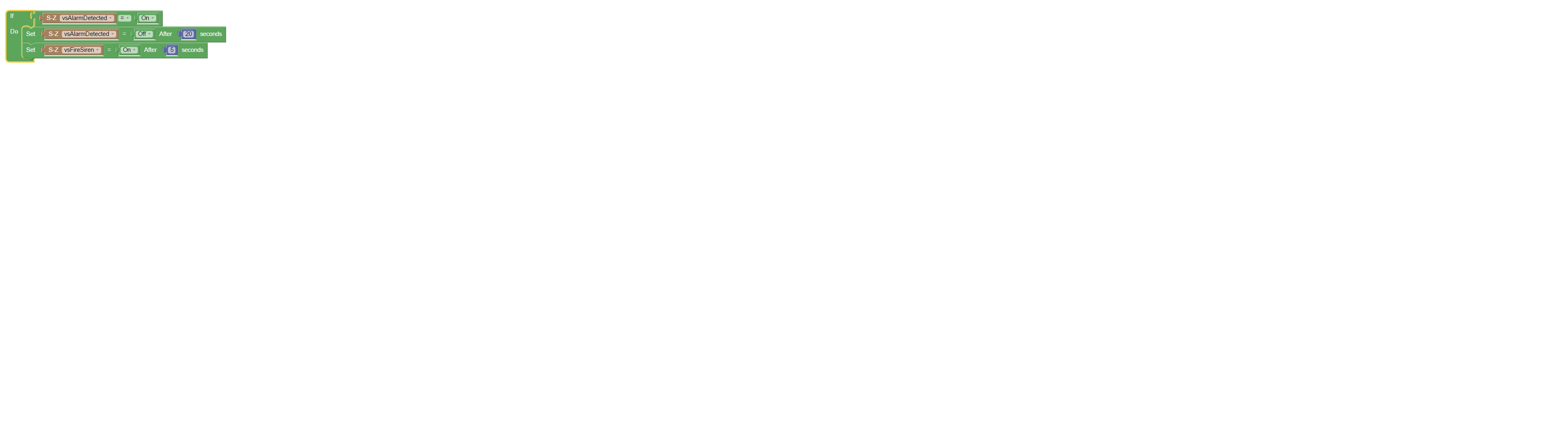

@JanKarel
I don't use lua scripts, but you're right. The motiondetection blockly is not correct. This should be the correct one, where the AlarmDetect is triggered and reset.
