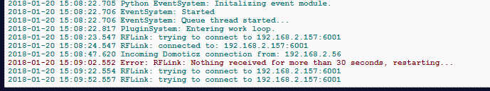

Posted: Saturday 20 January 2018 15:25
by brommetje
Hi @Bladerer yes I set the controller IP address, protocol and port same problem.
- output_log.gif (10.66 KiB) Viewed 4068 times
Domoticz is able to reach the serial server in the beginning and then trying ... no response.
I can login to the ESP without any problem, how can I check if the serial server is working on the ESP?

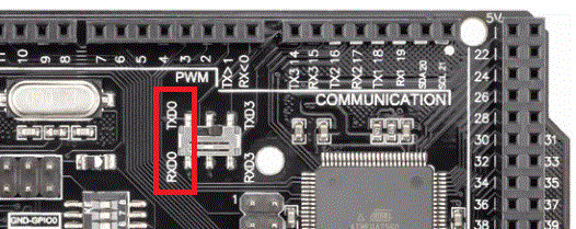

by brommetje
Hi, debugging with telnet is not working I think, but I found the problem.
- setting_switch.gif (51.74 KiB) Viewed 4057 times
You have to set it to RXD0/TXD0 otherwise no output.

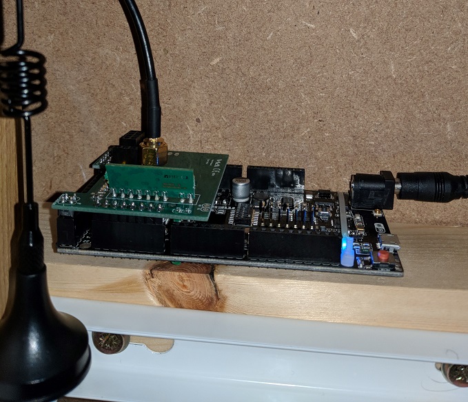

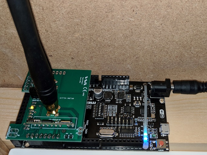

by max_g
The Wemos board suggested on page 2 is a fantastic solution.
The built in ESP and level shifter means zero hassle and makes a very neat solution, thats currently about to replace a RFXTRXcom.
no trouble to load perfectly with the ESP easy firmware ( make sure you swap the TX/RX switch ) to ensure you can connect
to improve the range there is a small advantage from the 3db antennaover the small finger that comes with the RFX.
( the real benefit is the extended lead allows improved placemnet )
interested in the feasability over over teh air firmware updates when RFlink releases >R48
- rflink+aerial.jpg (204.77 KiB) Viewed 3605 times
- Wemos-RFlink.jpg (211.86 KiB) Viewed 3605 times
