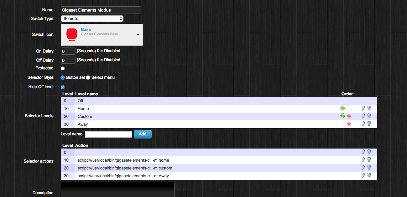

Create a new selector switch:
Set it up like this:
The actions are:
script:///usr/local/bin/gigasetelements-cli -m home
script:///usr/local/bin/gigasetelements-cli -m custom
script:///usr/local/bin/gigasetelements-cli -m away
also in your /etc/gigasetelements-cli.conf change:
modus: home
into
modus:
Otherwise every time you run the cli it will change the modus into home

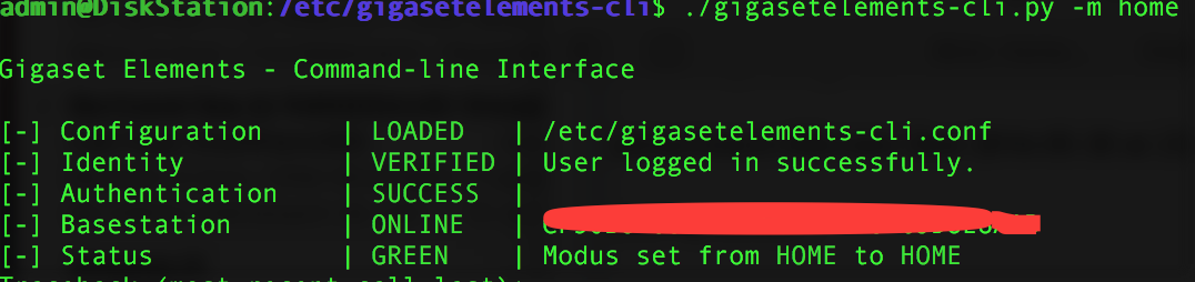

root@raspberrypi:/etc# gigasetelements-cli -tt
Gigaset Elements - Command-line Interface v1.5.0b1
[-] Configuration | LOADED | /etc/gigasetelements-cli.conf
[-] Identity | VERIFIED | User logged in successfully.
[-] Authentication | SUCCESS |
[-] Basestation | ONLINE | E52C011F30C1BE84C86895D96C76D693
[-] Status | GREEN | Modus HOME
[-] ERROR | UNKNOWN | HTTPConnectionPool(host='192.68.1.112', port=8080): Max retries exceeded with url: /json.htm?type=command¶m=addlogmessage&message=Gigaset%20Elements%20-%20Command-line%20Interface:%20Domoticz%20mode%20started (Caused by NewConnectionError('<requests.packages.urllib3.connection.HTTPConnection object at 0x763cd290>: Failed to establish a new connection: [Errno 101] Network is unreachable',))

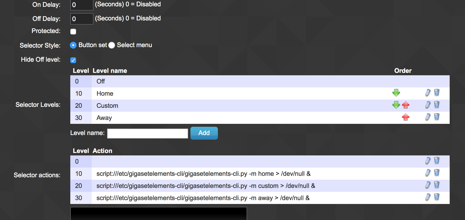

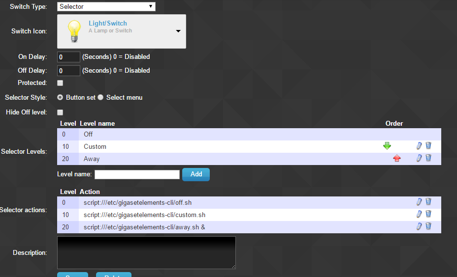

I have some problems with the gigasetelements-cli.
I have created 3 .sh scripts that refer to the 5 actions from the Gigaset Elements System :
but impossible to have the Domoticz working. No errors, but no actions.
For example, the away.sh script contain :
#!/bin/bash
/etc/gigasetelements-cli/gigasetelements-cli.py -m away -q > /dev/null
However, my scripts runs well in putty, changing the mode of the Gigaset Elements System.
Can you help me please ?
For information, I run Domoticz and gigasetelements-cli on my Synology NAS.

dynasticorpheus
- Posts: 115
- Joined: Monday 12 October 2015 15:26
- Domoticz version: 2.3295
Re: Gigaset Elements Cli - domoticz support
There is really no need to create separate scripts if you do a regular install. Please run below code:francocouly wrote:No, it doesn't work, like the previous settings :

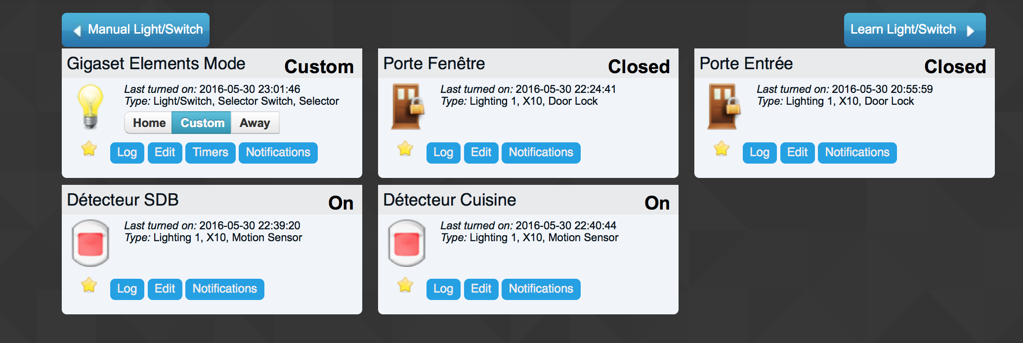

francocouly
- Posts: 6
- Joined: Monday 30 May 2016 17:16
- Target OS: -
Here is my configuration :
And my switch :
The sensors are OK, but still not able to set the modus with the script. It's running well in cmd line :
Thank you for your help

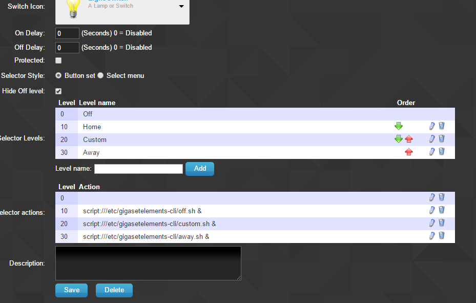

dynasticorpheus
- Posts: 115
I replicated your setup and it was working so we need to have a closer look, let's first route the output to a text file. Please share the output.francocouly wrote:Hi,
And my switch :
script:///etc/gigasetelements-cli/gigasetelements-cli.py -m home >> /tmp/gigasetelements-cli.log-
francocouly
- Posts: 6
- Target OS: -
thanks for your return !
when I add script:///etc/gigasetelements-cli/gigasetelements-cli.py -m home >> /tmp/gigasetelements-cli.log, no .log file can be found in my /tmp folder. Perhaps a problem of rights ?
dynasticorpheus
- Posts: 115
Can you try again using below .sh script? Perhaps you first need to "cd" into the correct directory due to environment constraints?francocouly wrote:Hi,

francocouly
- Posts: 6
- Target OS: -
Still not working.
the log file is created but empty, even if I add a "sudo -u admin" before the python command in the .sh script, add all the rights to this file, and the same for the log file
dynasticorpheus
- Posts: 115
I needed to specify the full path to python to get it working. Can you try as well. First check if it is also /usr/bin/python for you.francocouly wrote:Still not working.
#!/bin/bash
cd /etc/gigasetelements-cli
/usr/bin/python gigasetelements-cli.py -m away-
francocouly
- Posts: 6
- Target OS: -
Yessss ! It works perfectly
Thank you very much for your support !
