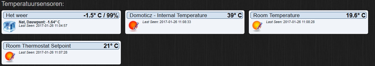

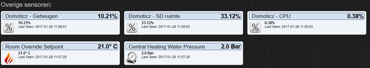

Hi There,
First post here and I will hope to contribute to the community myself.
Currently working on some sensors for my Pets (Bearded Dragons (Reptiles)) control and dashboard stuff.
@etamminga
Yesterday I got some solar panels and a new Boiler (Intergas) currently testing your 'driver'. Do you need some specific feedback sir?
I can read temp sens en boiler pressure and controle the setpoint. Also believe its working. If you need anything specific please give me a pm or question.
