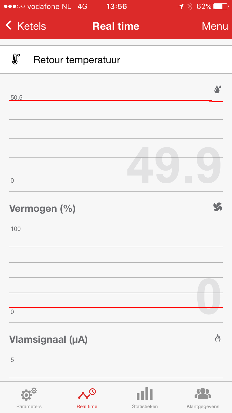

declan wrote: Monday 20 February 2017 13:57 First Thanks for iT, iT works great.
Maby you can add the return temperture of the cv and the power use
Mine is different?
And i looked into the API documentation (posted earlier) and could not find any power or return temperature strings...

Hi guys/girls,
I've just bought a Incomfort gateway with a Honeywell Round Modulation thermostat, with firmware version IC3-ICN-V1.12
In the app i only can see my fan and pressure.
I want to see temperatures.
Did i bought an old version :oops: ?
Or can i update the gateway?
I want to program the gateway in my domoticz (i have a Rasberry PI).
Can some one please explain me step by step what to do and how to program (i;m still a program newb)?
If u want u can send me a private message, maybe we can contact by phone or by email.
greetings, Tom
