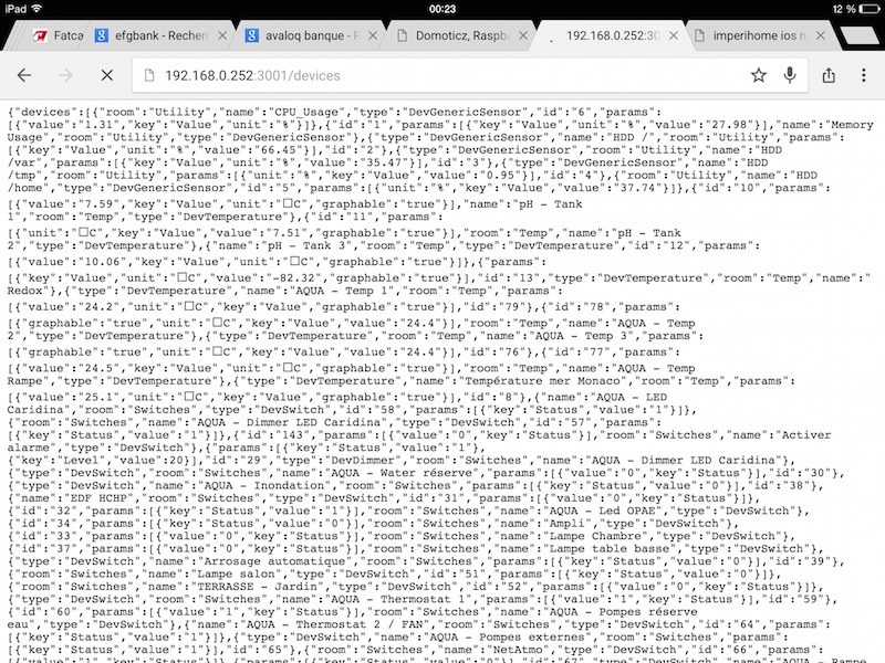

I'm trying to use Imperihome with my Iphone. All is OK (connexion between domoticz-Mydomoathome-Imperihome). But i have a problem with temperature devices in domoticz.
When i try to create few device like dummy switch to test, no problem with Imperihome. Example :
{"devices":[{"params":[{"value":"0","key":"Status"}],"name":"test","type":"DevSwitch","id":"6","room":"Switches"}]}
But if i try to add a temperature device (in my example motherboard rasppi temp), imperihome "loose" all device.
{"devices":[{"params":[{"value":"0","key":"Status"}],"name":"test","type":"DevSwitch","id":"6","room":"Switches"},{"params":[{"unit":"�C","value":"39.5","graphable":"true","key":"Value"}],"name":"Internal Temperature","id":"7","type":"DevTemperature","room":"Temp"}]}
There is a bad caracter degré in unit . Is this may be causing the problem ?

Just a small information. After discussion with Imperihome team and different test with my gateway, it's really an issue caused by degre caracter and encoding in ios apps.
" It happens that the HTTP response mydomoathome returns the encoded text iso-8859-1 with http headers that say the answer is encoded in utf8 ."
Android app known their way but ios app crash. A new update is expected soon.
Pending, Just a question. It is possible to force UTF8 in mydomoathome ?
Thank you.

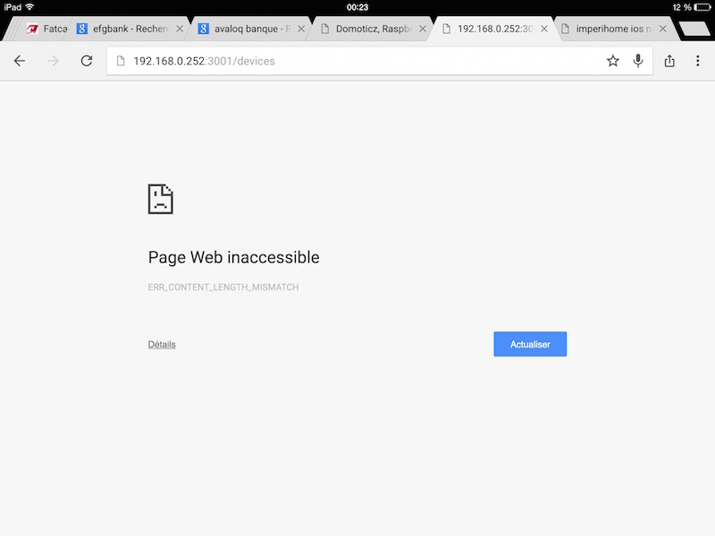

With my Android device ImperiHome work perfectly but I have a problem with ImperiHome on IOS (Ipad & Iphone).
I don't understand because I have my data on http://192.168.0.252:3001/devices with Chrome on my macbook but it's don't work on IOS devices.
In fact, on IOS devices the page load data few milli second and just after I have ERR_CONTENT_LENGHT_MISMATCH error and ImperiHome don't load data in dashboard:
For information, IOS ImperiHome work perfactly with my Netatmo account on Iphone and Ipad devices.
I update ImperiHome in my Domoticz with git pull but it's not solution.
Can you help me please?

For me it's exactly same problem
I add my ImperiHome server address : http://192.168.0.252:3001/devices ==> it's succesfull, but no device in IOS ImperiHome :-(
In my iPad and Iphone browser, when 1 load http://192.168.0.252:3001/devices it's same error "ERR_CONTENT_LENGHT_MISMATCH"
I use IOS 8.1.2, what is your version please?
I think the problem is not on my IOS devices but on ImperiHome server on Domoticz
For information IOS ImperiHome work perfectly with my Netatmo devices
Some suggestions please?

I've a similar issue...
from the iOS browser it's impossible to open the page... start loading and than crash.
Can be easily spotted what is happening, if you try from any terminal: "curl IPOFMYDOMOATHOMESERVER:MYDOMOPORT/devices |wc"
you will see something like that:
% Total % Received % Xferd Average Speed Time Time Time Current
Dload Upload Total Spent Left Speed
99 13403 99 13390 0 0 12395 0 0:00:01 0:00:01 --:--:-- 12398curl: (18) transfer closed with 13 bytes remaining to read
0 235 13390
It basically means that the server closed the connection earlier.
The most funny thing is that happens on my main server (intel nuc) with "Debian Jessie", if i try to contact the other micro server (RPI) with mydomoathome installed it's perfectly fine.
Any chance of a bugfix?
