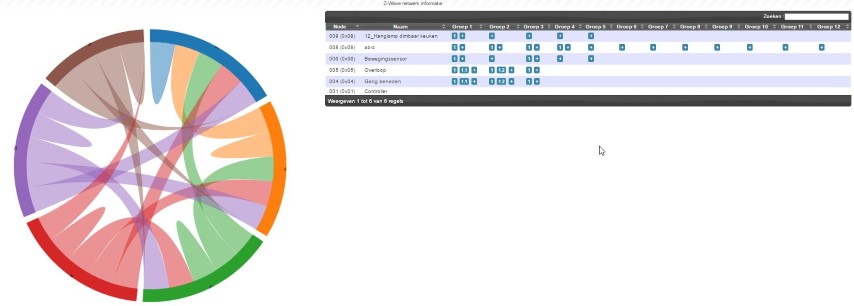

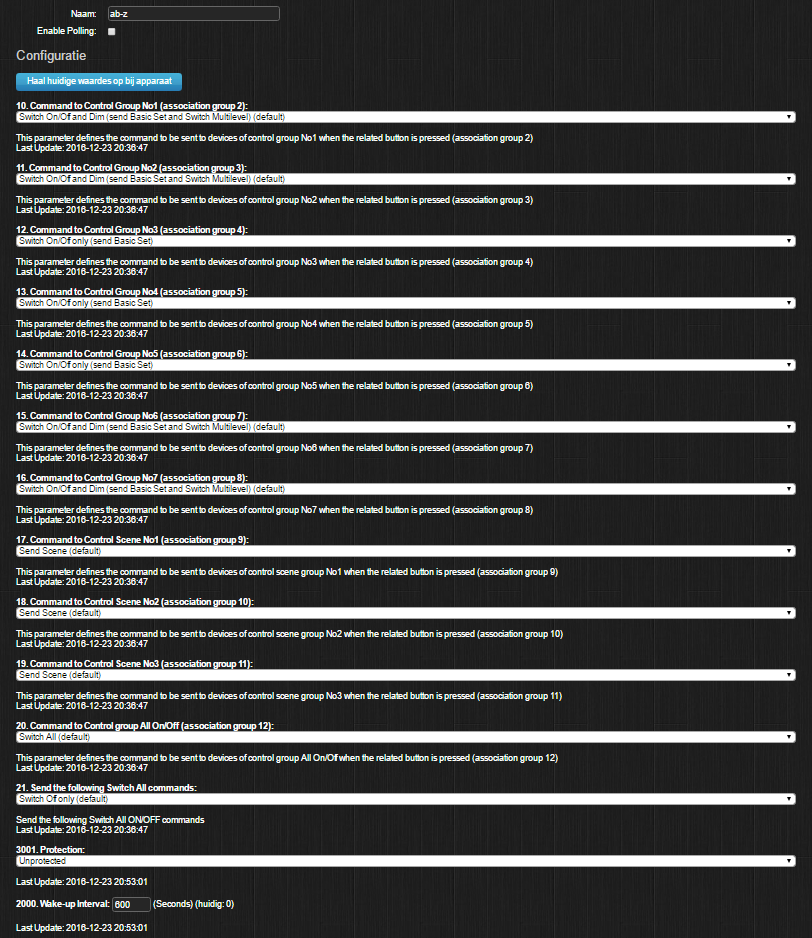

mcwieger
- Posts: 107
- Joined: Tuesday 08 December 2015 9:59
- Domoticz version: 2020.1
Re: Z-Wave.me ZME_RC2
It should be included in Domoticz by now:
Please check if you see the same screen as posted on 30 April 2015 (http://domoticz.com/forum/viewtopic.php ... 262#p41183). If that screen is there (in the Z-Wave device overview), the XML file is ok.
And while you are in that screen: please make the necessary adjustments there, to be able to use the buttons on the remote.
So no, you should not have to add the XML anymore.TheSpanishInq wrote: Seems the config is included in the latest version off domoticz (r5052)!
Many thanks to sarakha63 for getting this done!!!
I moved to HomeAssistant. It was fun while it lasted!

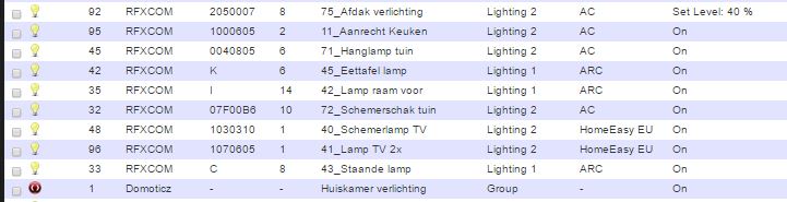

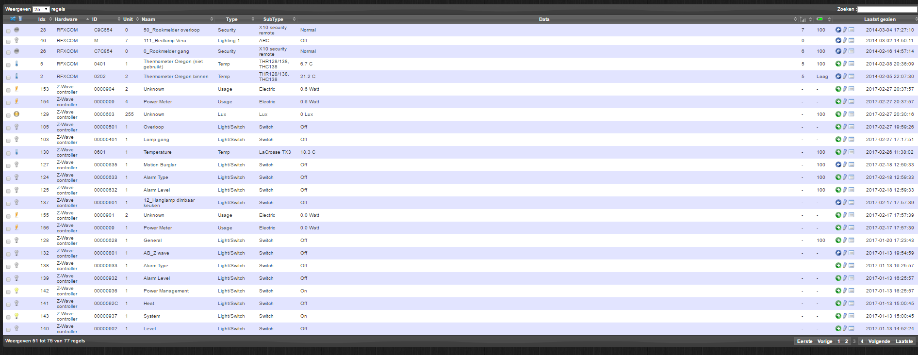

I have the same screen as posted 30 April 2015
I can also find the remote control in the 'devices'
i would expect for every button a different line in the 'devices' vieuw.
But i only see 1 line like this:
